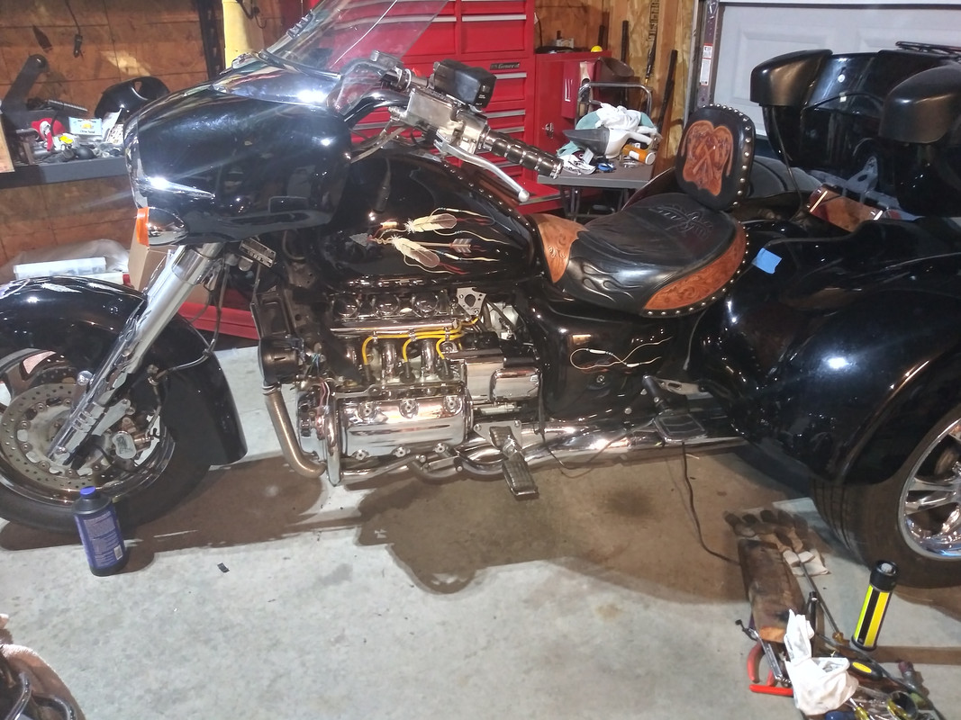

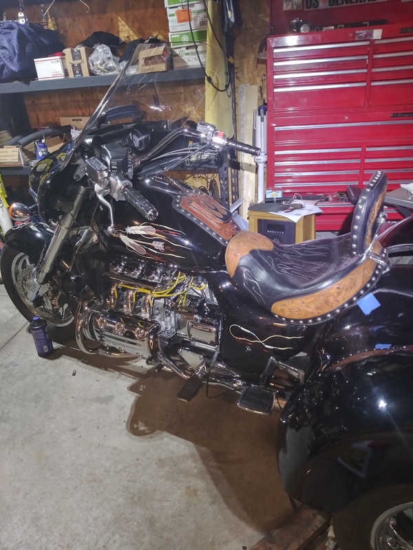

Finally had enough warm days recently so I could spend time working on putting it all back together. Today I put the final touchs on it after some wiring changes and additions. Recall I had rebuilt the carbs on the old bike last summer and had swapped them over to the trike. In general, the trike had been neglected but was basically a good ride as best I could tell. After working on it off & on the last few months....off when cold and on when warm enough for the IR heaters to warm the garage enough to allow me to work out there. Finally today I got it all back together with the exception of the pods with the fog lights. I siphoned gas from the tank going on the old bike and used it in the trike, made sure it was in neutral and with a little choke....hit the starter. It turned over real good but since the bowls were dry it didn't fire right away. I killed the ignition then turned it back on so the Dan Marc would open up to fill the carbs. Again with a bit of choke I hit the starter and it fired so quick it actually startled me. I let it run for about a minute and shut it down, then looked all over for any sign of leaks, drips, whatever. None...great! Started it again and was thrilled as how quick it fired up, something it didn't do before. After it had run enough to settle down and was able to kill the choke, I adjusted the idle to a point just below 1k rpm...so far it just sits and runs like it should. Crack the throttle and it's instant. So there I am with a big stupid grin wishing it would warm up and quit raining so I can road test it. When I do take it on the road, my son-in-law will be following me for a while....just in case. At present it doesn't have a back seat or the trunk mounted back rest. Both are in Texas being dressed up to match the front seat and tank bib. I created the back seat by cutting the rear portion off the stock one piece seat, trimmed it to fit and sent it south. I was able to move the tank over from the old bike, along with the front wheel, fender, brakes, and Corbin side covers. If I can catch up with The Mountain Man, I'll have him add some painting to the fairing, rear fenders & trunk. Here's a couple pics taken this afternoon. Not much to show really but you can't imagine the feeling to have it crank up and run good after all this time.
The handlebars are Wild 1 WO508, 1 1/4", still waiting on some support doodads to clamp on the bars to run the wiring & hydraulic lines through. Right now the wiring is just hanging and doesn't look good. Soon as I get the replacement fog light switch I'll mount the pods, then a good clean and polish. Also can't wait to check the cruise control operation, it's set up like it was on the old bike so should work fine.

I tried but remember those controls were HD and took some special work to adapt to Honda. When I went looking for the instructions to adapt them to the I/S, they were nowhere to be found and I decided I didn't want to reinvent the wheel so went with OEM controls. I still tried running the wiring inside but even after some major cuts to allow a larger bundle to go through, it still didn't look good or work out right so I dumped the old bars for new ones. They're the same 1 1/4" model bars, just new and look better...old ones had nearly 15 yrs. of wear and had major cuts underneath. The new bars are almost an exact match to OEM I/S bars but I like the feel more than the stock. All I had to do was drill a small hole on the bottom for the small tab in the controls that keeps them in place. Just need some hangers to run wiring and hoses through so they aren't just hanging there.

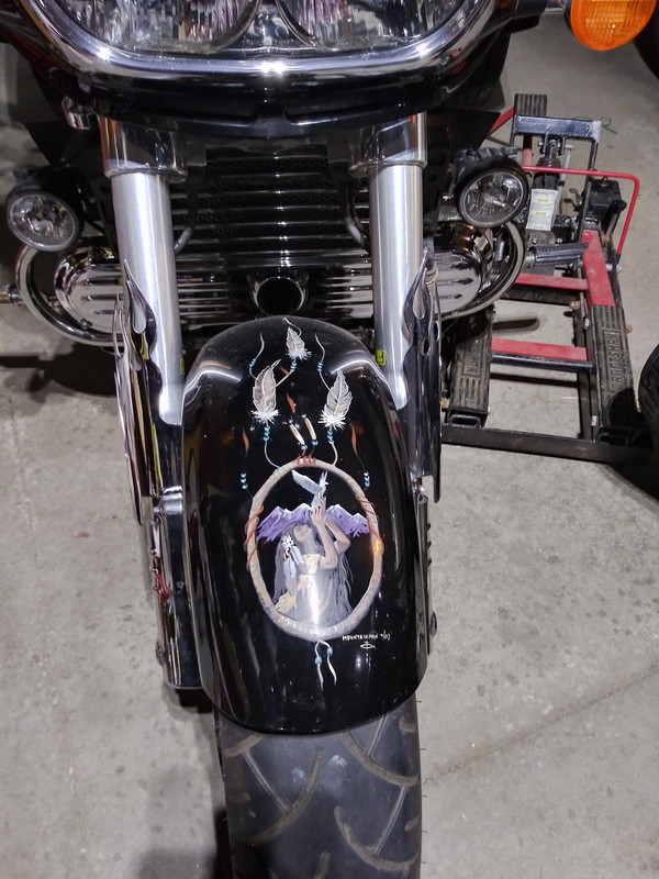

I recall seeing that tank painting a long time ago. I have a painting on the front fender that The Mountain Man did at IZ 3 in '03 and it still looks good. Here's a shot taken just a couple months ago....excuse the bright light reflection down the center near the bottom.
