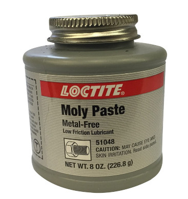

I've done "the maintenance" numerous different ways
that have worked fine. Packing the splines with waterproof
blue belray grease seems to work. This stuff, or probably
any other moly paste, does fine...
