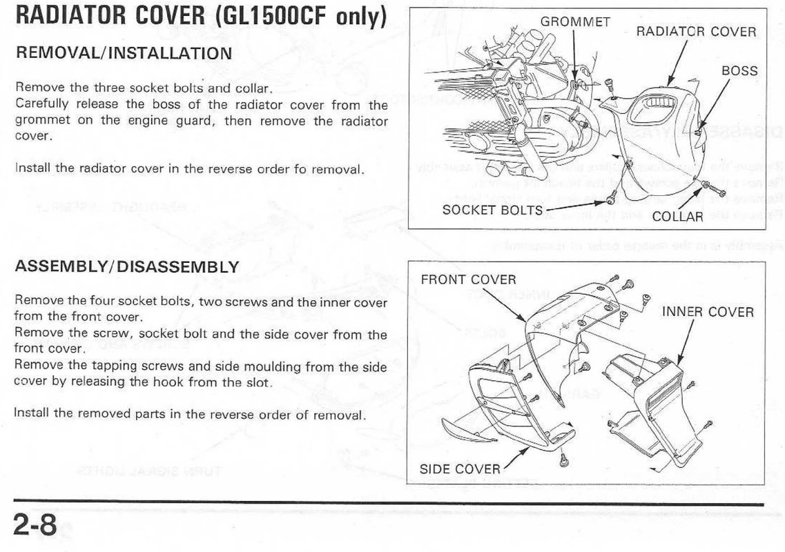

« Reply #1 on: April 15, 2021, 02:44:45 PM »
John, does this IPB help?
Posts: 15347
« Reply #2 on: April 15, 2021, 03:31:18 PM »
I was trying to keep from doing all that disassembly but might be the easiest way, those vents just snap in. I have pods on the Tourer with chrome vents installed, maybe I'll just swap that part they're mounted in rather than try to slip just the vents out. Whomever installed the pods on the I/S trike did a lousy job, the grommet surrounding the lamp isn't centered on the left side. Haven't tried installing the right side to see if I can adjust it to fit right. If not...it will have to stay the way it is.
