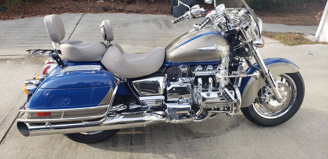

I did not document the progress like you did, but I had a rusty Valkyrie that I am in the process of restoring. It started out looking like this:
This was a couple months ago. Still a work in progress, but getting close.

« Reply #46 on: May 12, 2021, 12:38:35 PM »
Mooskee has a nice looking Valkyrie...
« Reply #47 on: May 12, 2021, 12:48:06 PM »
cooldude I love the colors  cooldude

Thanks guys. It is a labor of love. I replaced all the painted parts with parts from an IS. The fellow that had owned the IS, was involve with a Formula 1 racing team and he had the bike painted with the team colors.

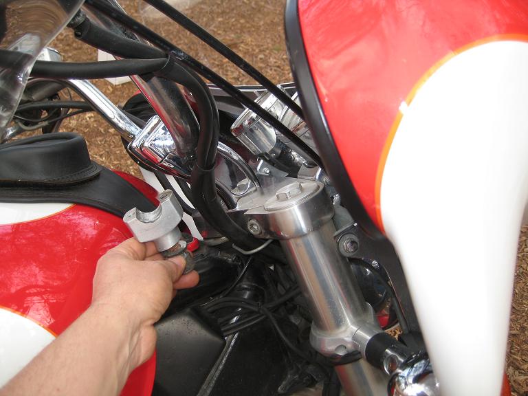

Posts: 31184
« Reply #57 on: May 14, 2021, 11:41:54 AM »
There's lots of very good riser threads on here (over the years):  Do a search.  But many old links to risers will not work because the companies are no longer in business (or moved to some other named business).
The OE risers are 3 1/8".  Most people (short and tall) like taller ones.  Most give both height and pullback (since the trees are angled, taller always give some more pullback, but most all risers are curved, giving even more).
You can go to about 4" with no cable changes at all.  Std/Tourer throttle cable housings to bars is higher (out the front) than interstate (out the bottom, and give a bit more stretch with taller risers).
Now that is only a 7/8" rise and pullback, and there used to be 1" riser spacers that could be dropped onto the stock risers with longer bolts to get a good result, and for cheaper than aftermarket riser sets, but they may not be available for Valk anymore, I dunno.  You have to look.
They look like this:
Beyond 4-4 1/4" tall, you can still avoid longer throttle cables by rerouting them inside the tree.  (After padding the tank, you loosen the bars in the risers and slide them sideways left to get slack to unhook and reroute, and hook up again.)
I have 5.5" Harley Deuce knockoff risers on one bike, and the reroute gave enough length without longer cables (but that's with the interstate bar throttle housing coming out the bottom).  To make those risers work, you also have to cut the domes off the bottom of the risers and either go to SAE to metric conversion bolts, or drill out the tree bolt holes by just a few thousandths of metal (and you can always go back to metric if you want to with no problem or wobble.)  The only other thing with these is you need to turn the plastic wire routers on the back of the handlebars around 180*.
These conversion bolts save drilling and will work on any SAE Harley risers you may find.

The problem is the old LaMonster or Aeromach 4" risers may not still be available.  The Harley deuce knockoffs probably are.  You have to search, and some risers now for sale will not mention Valk in fitment, not because they won't fit and work well, but only because the bike has been out of production for so long.
These are the old 4" Aeromach/Lamonster risers.
Going from 3 1/8" stock to 4-4 1/4" aftermarket risers provides enough relief from shoulder strain or leaning-in for most reasonable length people.
My 5.5" Deuces are very comfortable just cruising, especially leaned back on the backrest with my feet up on the Hwy pegs, but at full lock (walking speed) my hands/bar ends do come back close to my thighs.  No problem at all though.  But cranking and banking though the mountains, I prefer the 4" Aeromachs.

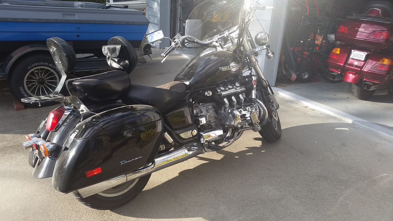

Valk with Harley Deuce risers. (I cannot be sure, but this guy may have the interstate (out the bottom) handlebar cable housing on there)

This picture shows the bottom raised ring that must be cut off.
https://www.ebay.com/itm/401130417941
https://www.easternperformance.com/bikers-choice-chrome-softail-deuce-pullback-riser-set-for-harley-fxstd-00-46.html
Match these with the Baron's conversion bolts.
