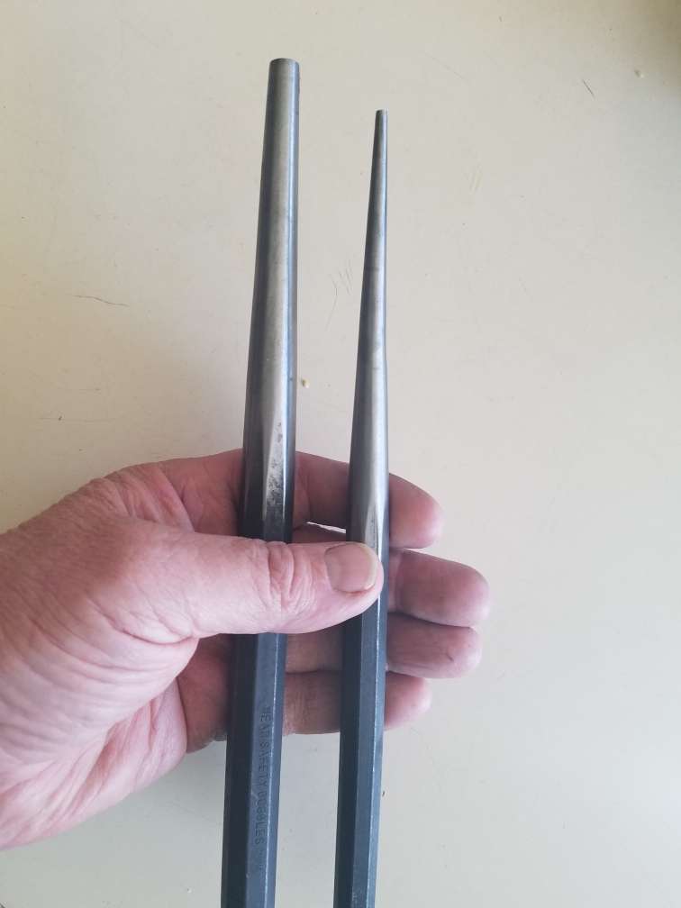

The metal of the filler neck is very soft.  I have some tapered large punches I think I got at Harbor Freight but I don't find them listed there right now.  Just pushed through the existing vent hole while moving it back and forth.  Opened the hole up to more than a half inch.  Took maybe a minute.  I didn't make multiple holes.  Probably a good idea.  I wrote this up on my tech tip pages around 20 years ago.  I would revise that article now to say a hand-turned drill is overkill - like I said, I found later on Jade & George just pushing a tapered punch or the like works well and doesn't leave filings to recover.  The hardest part is just having a large tapered punch shape.  http://horseapple.com/Valkyrie/Tech_Tips/Burping_Brunhilda/burping_brunhilda.html
