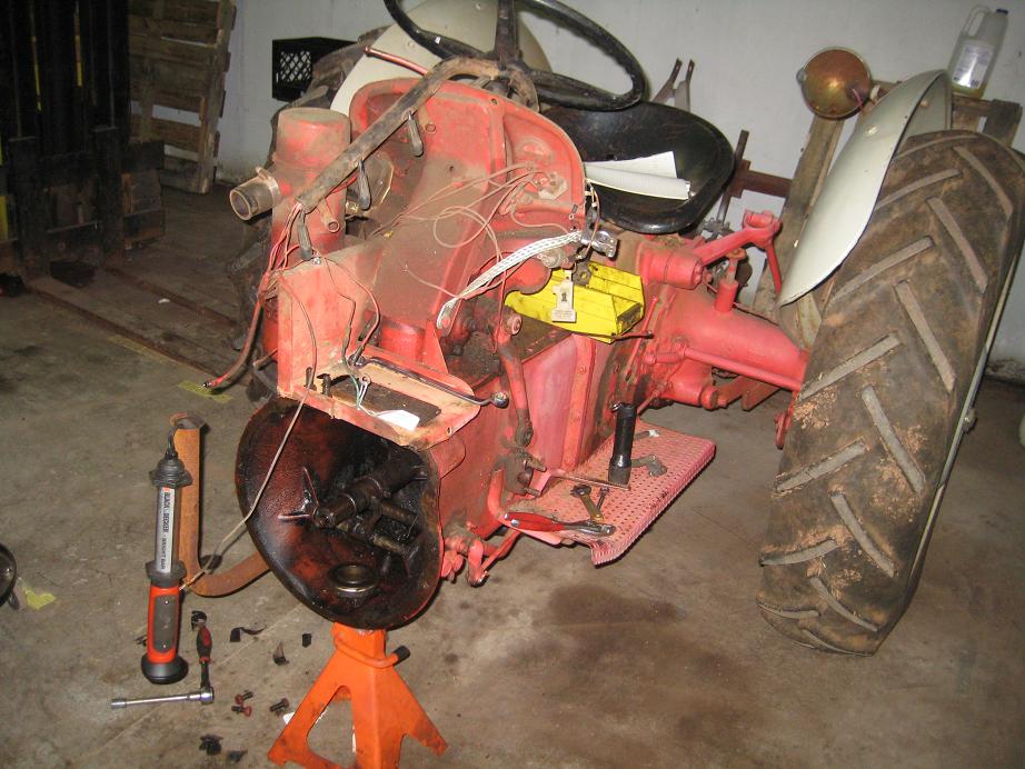

But other times it refuses to engage until I bump the engine over a little bit, then it turns just fine.
On my 8N (8Ns in general, and maybe even "stuff" in general, ida know)
the ring gear would generally stop at the same place every time. The starter
would engage on the same few teeth right there pretty much every time.
Those teeth wore down on the ring gear and after a while my tractor
did like your bike is doing. It is a drag bumping the engine over a little bit
on an old tractor :-) ... I'd put it in gear and grab the lugs on the rear tire
and grunt it through a couple of teeth...
Anywho, I eventually got my tractor broken in two to get the ring gear
replaced...
I hope you don't have to break your Valkyrie in two!  Shocked
