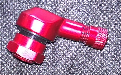

FYI the aluminum stems Jess mentioned also come in colors.
