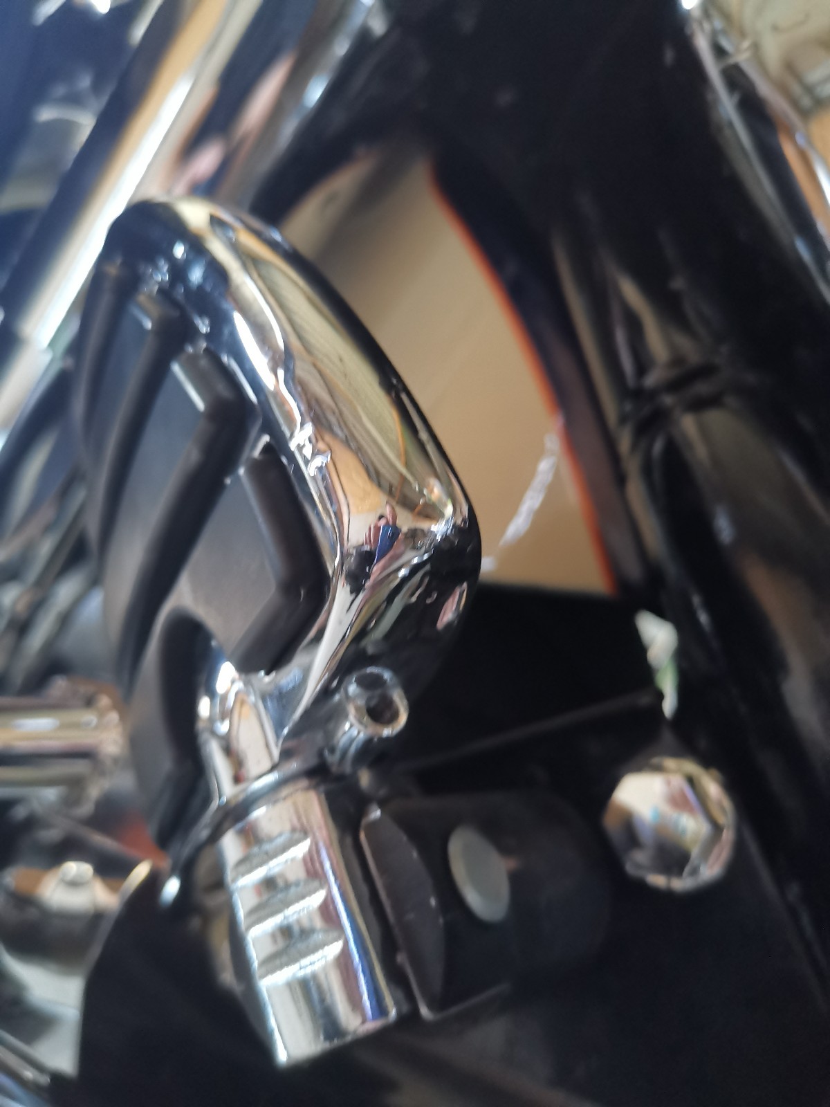

I'm not into imperial sized screws so I need some help:
What's the screw size/gauge for following items:
Kuryakyn ISO Wing Mini board set/grub screws:

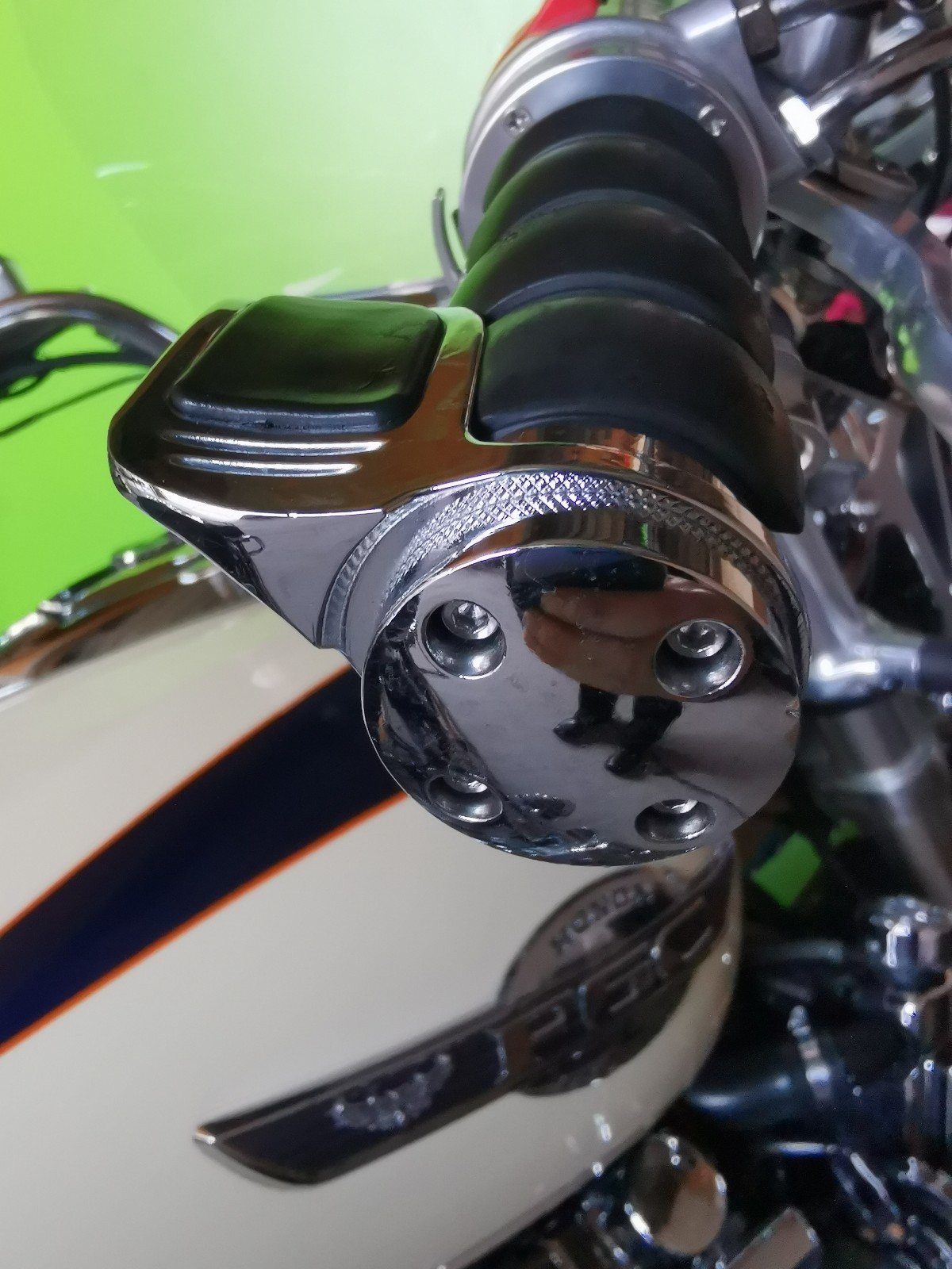

Kuryakyn ISO grip end cap screw. (Also length needed if I would remove the throttle boss )

All the Kury footwear are all SAE from my experience. The grip end caps are 4-40 SAE. I've lost some thread in one hole of mine and retapped to 6-32 SAE w/o any issue with fit.

I believe this is correct.  Way back at startup, Kury principally catered to Harley (and a US market) so most things are SAE.
Seems to me you can google Kury parts/install descriptions/lists (maybe PDFs) and they should have screw/bolt sizes.   Or call them.

HIGH TENSILE 12.9 UNC UNF GRUB SCREWS SOCKET SCREWS CUP POINT 10-24x1/2 for the Kuryakyn Foot Pegs/Wings do fit as a replacement.
