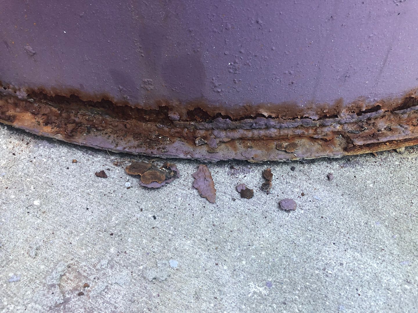

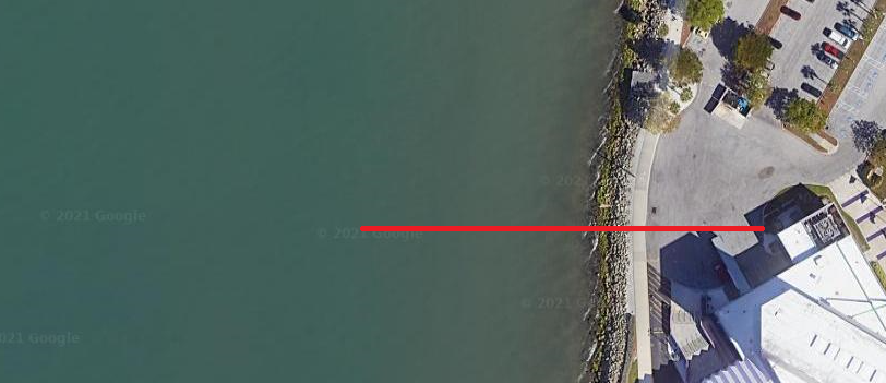

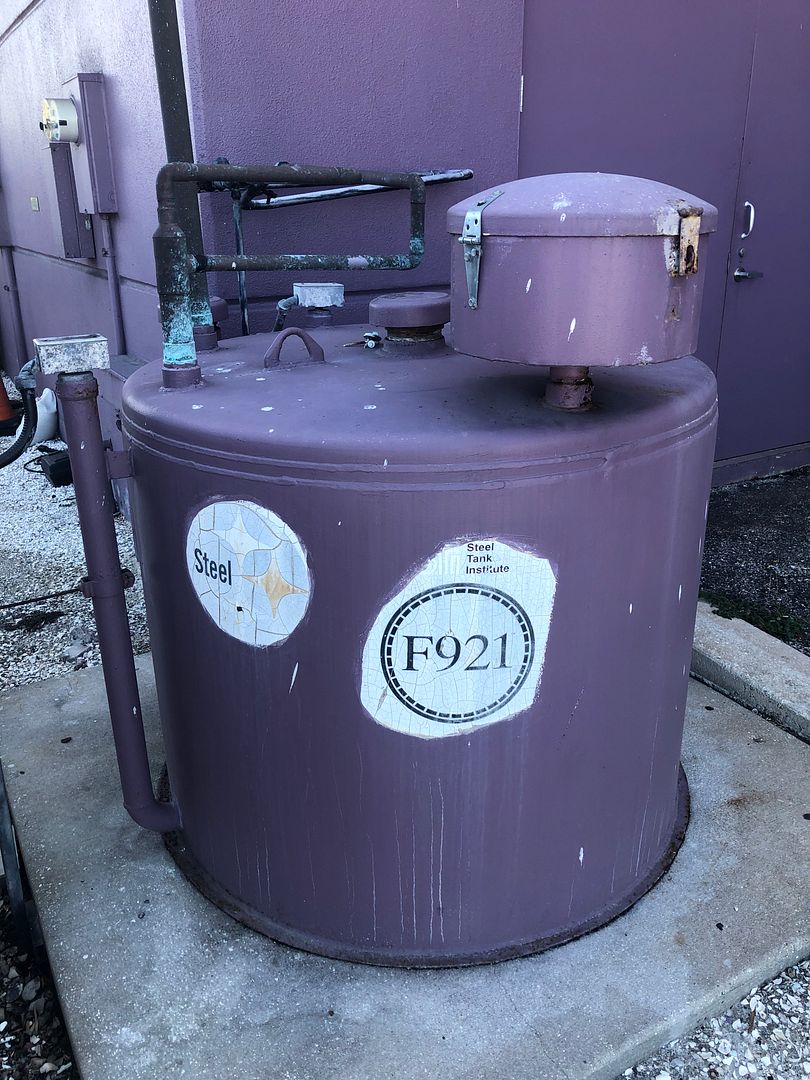

« Reply #10 on: June 09, 2021, 01:21:24 PM »
Some pics

I'm sure that will buff right out.   Grin
If that was my company, the first thing I would do is look for the paperwork (contract) on the install of that tank, and then contact that company and ask them to look it over and what they think about it.

It will be the same answer as the HVAC (Trane)........ You placed it near the salt water.    I have reached out to the company with pictures, waiting for reply. Im sure it is time for a new tank and it looks like the prices are not that bad.

Depending on the wall thickness, that may be able to be cleaned up and repainted.   Of course, replacing the tank is never a bad idea.   My biggest concern would be that there doesn't appear to be any barrier to keep that potential leak or spill from soaking into the ground (when it eventually does happen.   Groundwater contamination is something the EPA looks at as a pretty serious issue.
