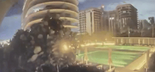

« on: June 24, 2021, 02:18:03 PM »
https://www.dailymail.co.uk/news/article-9720381/Eleven-story-Miami-Beach-apartment-building-collapses-sparking-huge-search.html

« Reply #4 on: June 24, 2021, 03:51:26 PM »
Was watching the videos of it falling and the first thing that fell straight down was the center of the building. Then the rear half fell almost straight down but inward towards the center.

« Reply #9 on: June 25, 2021, 05:46:47 AM »
Watching the vid, it does appear the roof collapsed first.
But.
All it would take is just 1 or 2 of the ground level posts to be compromised, either by sinking, deterioration, displacement or overloading for this type of structure collapse.
Once the load support is lost, the additional load transferred to the remaining posts is overwhelming and a collapse is imminent.
These buildings with open parking in the ground and second levels are more prone to collapse than buildings with more bottom level structure, as has been discovered in CA earth quakes.
Florida State Building Code required this building to be "recertified" every 40 years and it was in process for that certification.
Probably that time frame will be modified.
It's been reported the roof was in the middle of a upgrade.  If the contractor over stacked materials on the roof in one area, possibly over a already, but not known, compromised post, the additional weight could have caused the post to fail.
If the failure started on the 12th floor or the 1st, the final outcome would be similar.
It's been reported 159 are missing.  Tragic.
