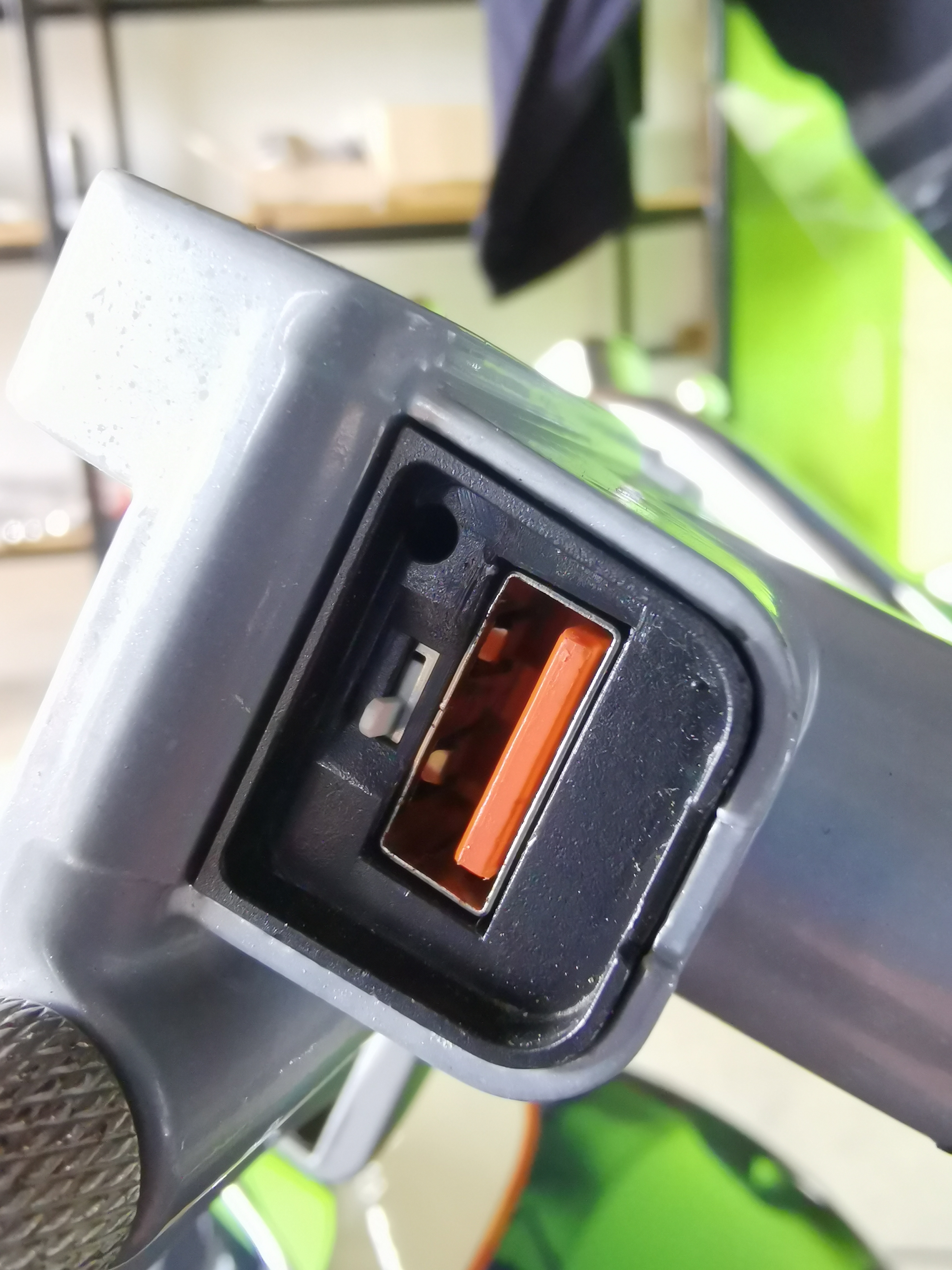

My understanding is most of those USB ports always draw power even when nothing is plugged in
That's why some ports have an extra switch. See the USB port of my cradle:
I don't need it powered permanently, though. Connected on acc circuit.

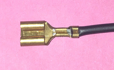

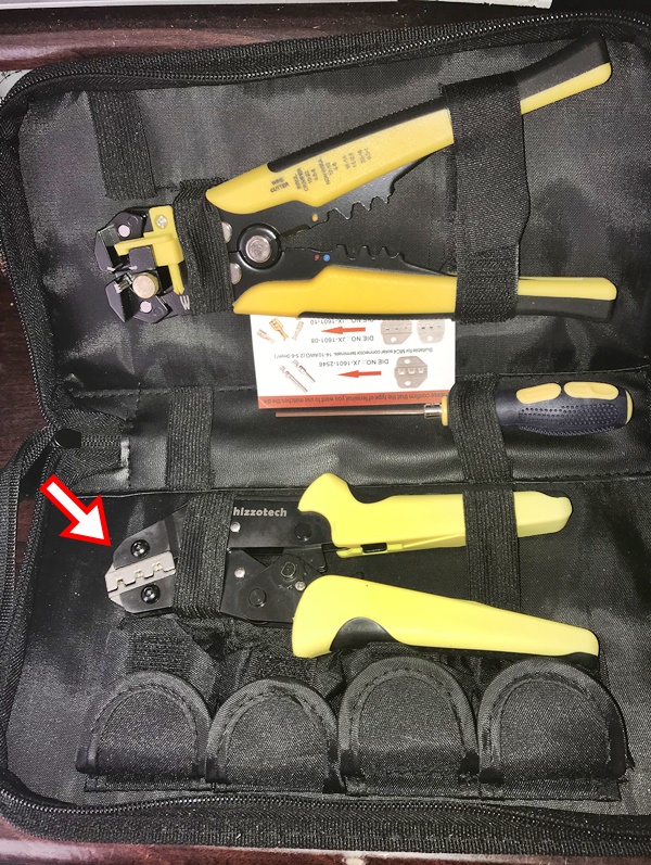

I also use to think solder was the only way to go. However, this is how my crimps are today using a ratchet crimper. I still add a spot of solder if possible. Ratchet crimpers have dropped in price, but I did return an inexpensive ratchet crimper because it didn't function properly. My current kit came with a speedy wire stripper and a zippered case.
