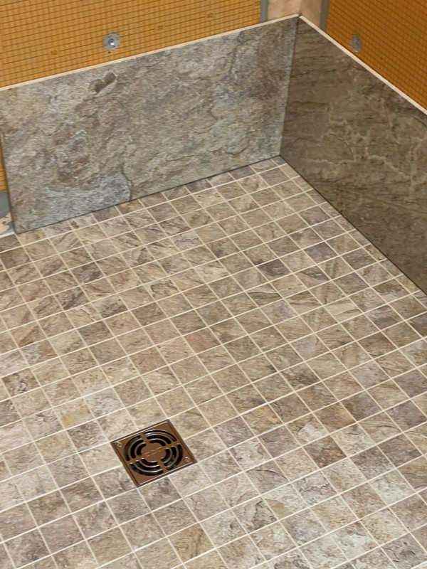

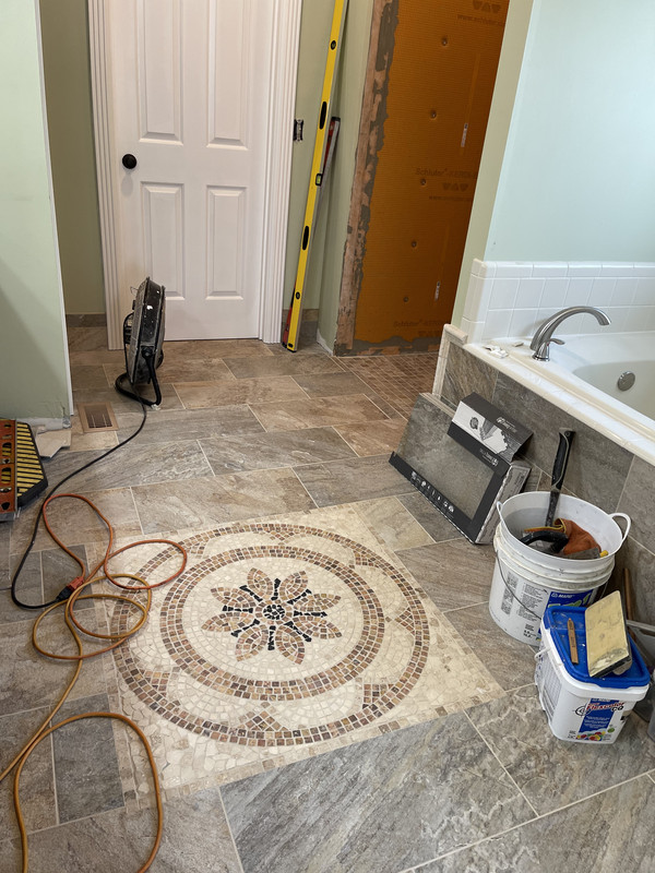

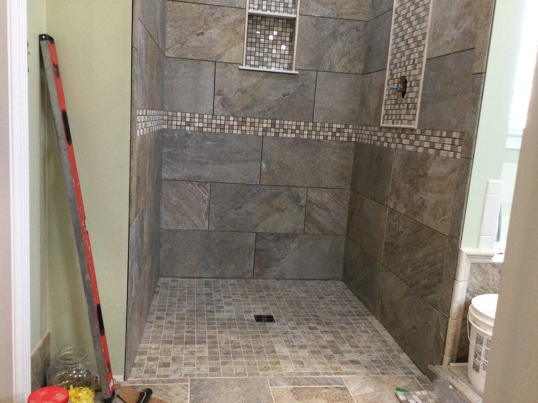

Decided that the fiberglass showers long term health didn’t look good so I ripped it out. Always thought I wanted a curbless shower so that’s what I’m going with. Didn’t help that I made this decision after the bathroom tile had been laid right up to the fiberglass unit and that I extended the shower from the 32” deep fiberglass unit to a 48”x48” tile base.
I figured if I live here long enough someone may have to roll me in for my shower!
Going to use the same 12”x24” tile on the shower walls as is on the the rest of the bathroom floor.

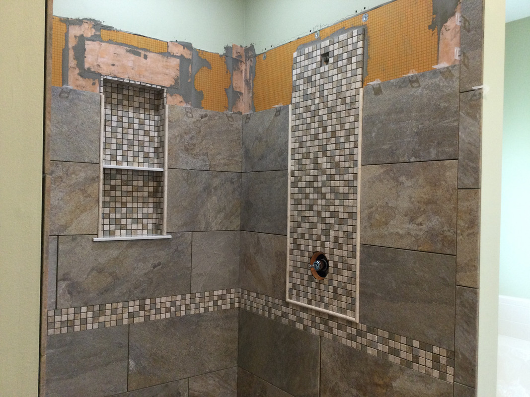

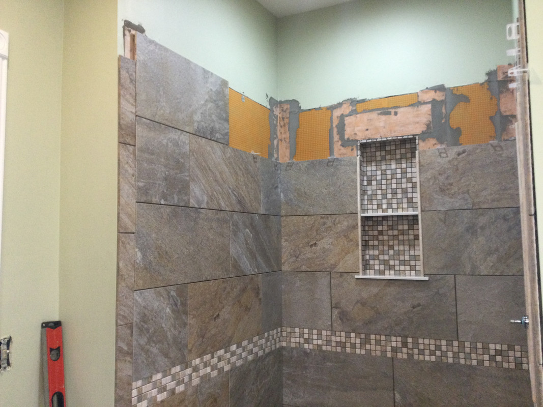

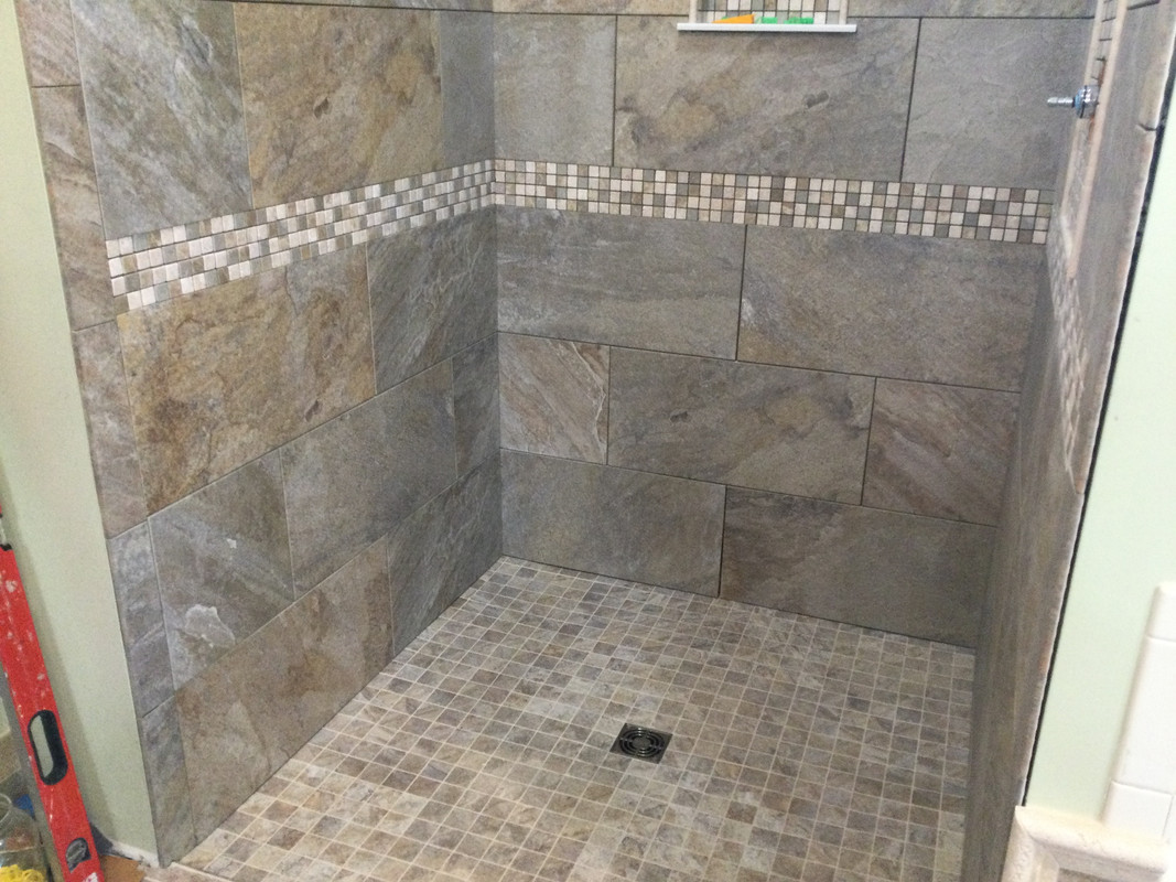

A little update on the shower project. I’m on the last row of tile and trim!
My shoulder is already aching just thinking about the grouting ahead of me.

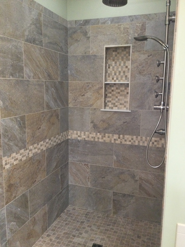

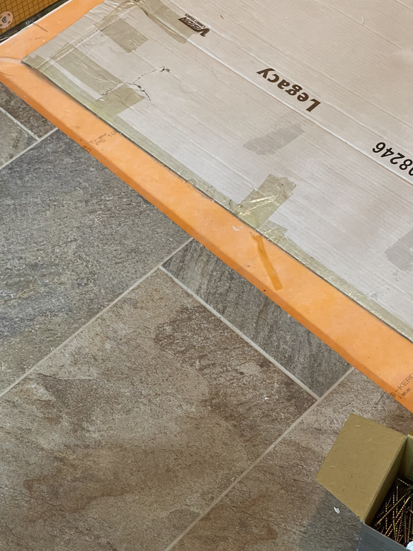

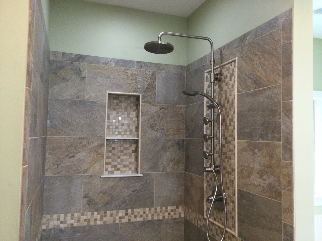

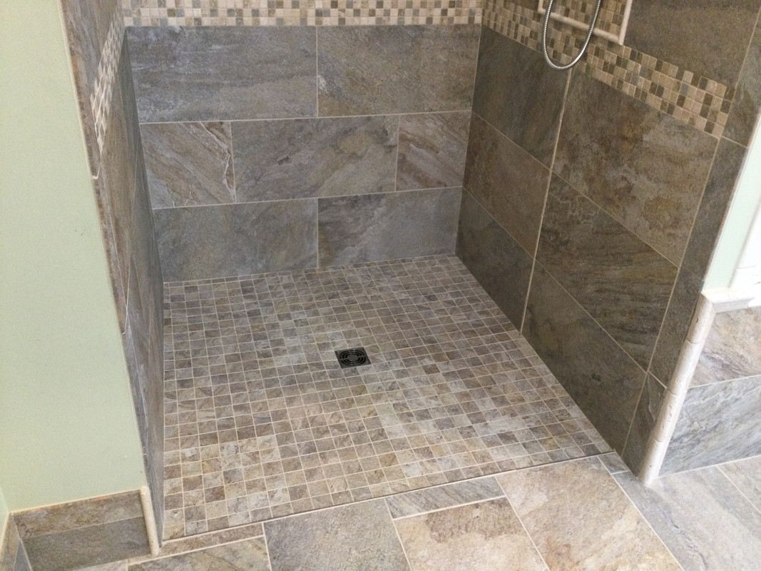

I finished the grouting and clean up of my shower project. Just a few more small items ( switch and outlet covers, drawer and door pulls  attached) and the punch list for the master bath is done. I’m having new bedding delivered at the end of the month so after living here for 2 years, I’ll sleep in the master bedroom for the first time.
I decided I didn’t want wood base boards in my baths and utility room so I cut tile strips and capped it with bullnose trim to finish it off.
Thinking about frameless glass shower doors but haven’t decided on one yet. Probably just use a shower curtain for a while. You could probably buy a new Cobra light bar for what shower doors cost these days!

Very nice looking job! What are you going to seal it with? I'm assuming the floor is limestone? What about the other tile, is it natural stone?
[/quote]
No sealer at all. The tile is all ceramic. The mosaics do have some natural stone but they won’t be an issue. I used all Schluter products from floor to wall boards and mortars along with their Kerdi membrane for all the corners and joints. They even have a specialized drain to work with their system of waterproofing. Be using their products for years.
