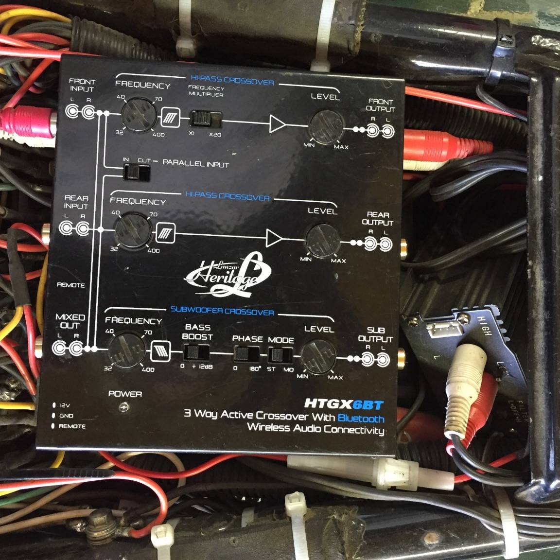

John, I found I can't trust BT to stay connected.  Hardwire doesn't have that problem (generally - until the male/female connectors get crud in them; then need cleaning).  I have run Garmins since before the govt shut down Selective Availability - May 1990.  Most were GPS players as well.  Presently a Zumo 665.  I installed a 300w bluetooth Lanzar Crossover / mixer between the player devices and the 400w Kenwood amp, to pair with my phone (and Garmin) using sound aps like Pandora (Garmin, the MP3 player and turn directions), when consistently within cell tower range (like when playing music stopped at Motel parking lots, spinning Markaritas etc.).  BTW the Samsung phone has a 128GB SD micro card so it can play a HUGE MP3 library w/o cell connection - just under 10,000 tunes. The Zumo is "magic number" limited to 2,000 MP3's per card.  Found bluetooth unreliably connected so hardwired it to the phone instead (already had the GPS hardwired).  My bikes are set up with amps to play through speakers.  If I were you I'd abandon the BT method; hardwire instead.  This will solve the battery problem as well.  Of course that's another wire to plug in if you use earbuds.
In this shot, wires not as curently connected - now all 6 plugs, left side are connected, "front output" wires top right moved to "mixed output"; the phone inputs go into "rear input".

Mark, that's quite a panel you have there. For me, I'm just going to find a long enough cord to go from the GPS on the handlebar mount back to the aux plug near the battery. Over the years I've seldom listened to a radio while traveling so having the GPS output come over the speakers is of no concern. Locally, pretty much the same feeling...partly because I find bikers with their volume cranked way up so they can hear it and it's a bit obnoxious. I agree re. BT dropping out, happened all the time using earbuds and my phone. I'd suddenly realize there's nothing coming out and I'd check...only to find the buds have shutdown due to no input and the maps on the phone has stalled. Can't tell you the number of times that sent me down a wrong road because I didn't get any input, so I'm going with a solid connection soon as I can find a long enough cord with the 3.5 male on both ends.
