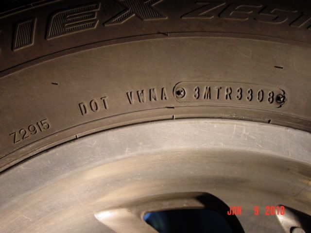

Someone sent this to me and it got me questioning the age of my new tires.  The code on my tire appears to be 2412.  Does anyone here have more info on these codes, because according to the vid. My tire was made in June of 2012, after the world ended.

I think some of you are missing the point here.  This is not something you can see on the tire.  I have had plys break, bubbles on the sidewalls, loose pieces on the tread.  These are things you can inspect and see.  What this video is talking about is CATASTROPHIC failures that you can not predict.  I inspect my tires regularly, with only 2 on the road I want them to both be at their best.  I do not wear them below the reccomended limits, I watch for anything odd, but this seems like something that can be controled but only by knowing WHEN the tire was made.
     The point I was getting at (besides hoping to spread good info) was HOW CAN I TELL HOW OLD THIS TIRE IS

The tire has a date code on it somewhere, I don't know the code,or how to read it, but somebody here does.  Hoser
     Hoser,
                 Have you read this thread?  That is the point.  I  have this on 2 forums so I may not have explained here.
What I am looking for is the date code info for my tire.  It is a Falkien and the numbers I got off of it are 2412 which indicate that it was built in June of 2012.  So far nobody has helped me with my question.

I guess that if you are reading the right series of numbers and reading them correctly then the only possible explanation is that the date code was set incorrectly at the time of manufacture. The tire sure didn't time travel to get here prior to it's date of origin.
Posts: 16631
« Reply #15 on: January 08, 2010, 08:00:57 PM »
If you're really giving us the last four digits of the serial number, the tire was manufactured either June of 2012 or September of 1992.  One seems improbable and the other impossible.
Those are U.S. D.O.T. rules.  Is there any possibility the tire was manufactured for use outside the USA?

At this point I must have the wrong number, I will recheck it tomorrw.  I was questioning if different manufaturers had different systems.  Sounds like the standard is the DOT #
Posts: 16631
« Reply #17 on: January 08, 2010, 08:11:14 PM »
You're looking for the last for digits of the full serial number.  A short number will be on the opposite sidewall.
You are correct.....in preparation for the change in the law that will require the dot code to be branded on both sides of the tire, tire manufactures have started branding both sides of the tire with the part of the number that doesn't change, which is a part of the mold.  The last 4 digits change weekly, and are branded with a changeable plate.  So when that time comes all of the number will be on both sides.  Before the year 2000 there were only 3 digits at the end of the number so it might be hard to tell between a 1981 and a 1991 tire based on the dot code.  After 2000 with the 4 digit code, first 2 being the week and the second 2 being the year, no question as to when the tire was made.

Look for something like this on the tire...(week 29 of 2008)

then 4 digits like in the pic.  I suspect you may have a different set of numbers on the other side of the tire with the DOT in front.

Here is the code from my Falken, the other pic was from a Dunlop front tire. So my tire is week 33 /2008. This is imprinted only on one side of the tire.
That looks like what we were expecting.
That clears it up for me.  My vintage mustang has 12 year old radials, according to that.  Since I only drive it about 500 miles a year, I doubt that I will buy new ones.  My Bridgestones on my valk have been on a year,  they are 3 years old.  I'll be buying it new shoes before Inzane 10.  Got about 12k on them.  Thanks, Rio.   cooldude hoser
