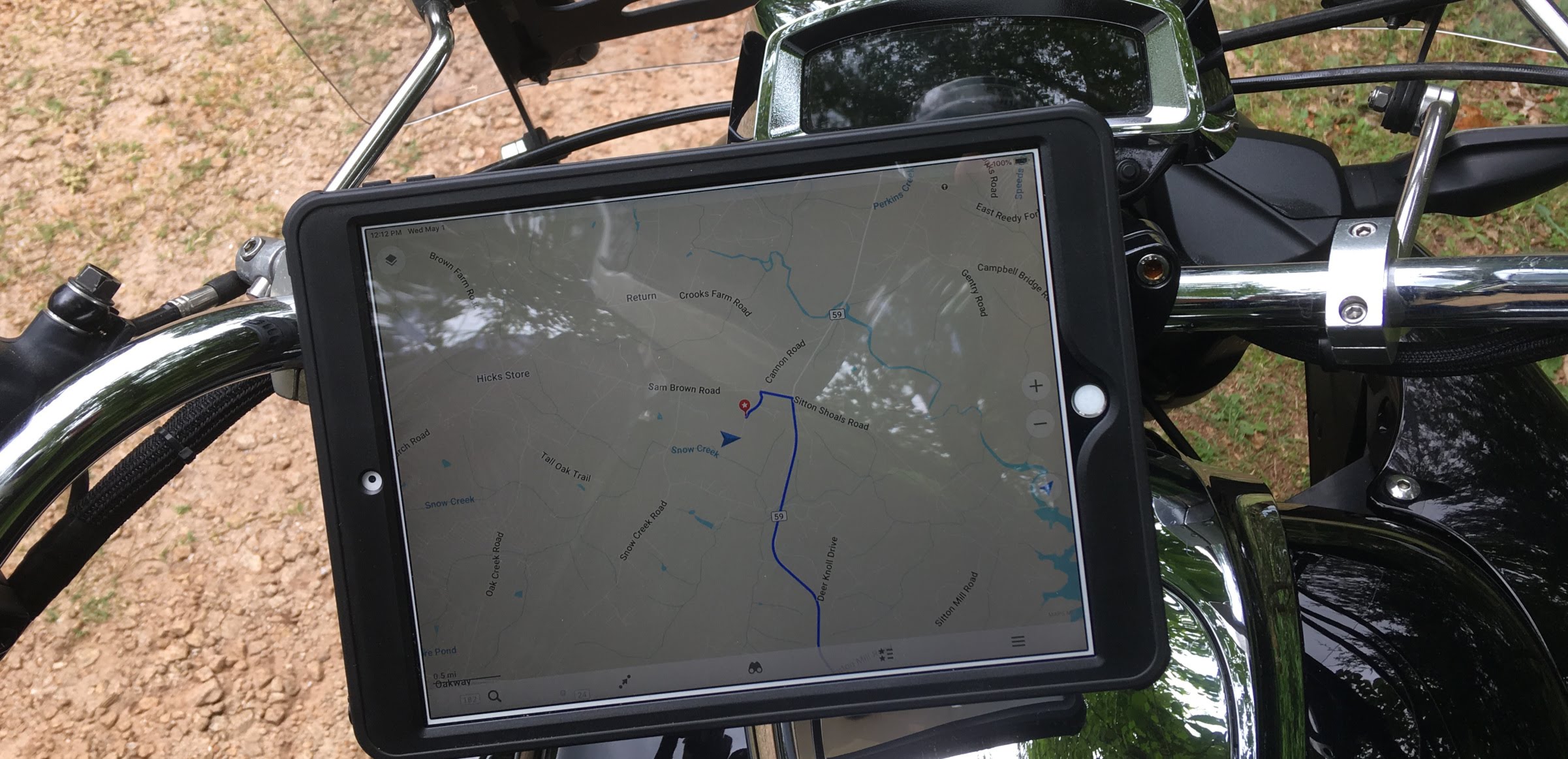

Colorado and New Mexico was one of the first places I used the BFGPS...
My bike's not turned on in this picture, but if it was that little black
bar on the top right would be GREEN to let me know the BFGPS
is staying charged.
Part of the way through my first day on that trip I looked down and the
bar was half green and half black... I'M NOT CHARGING! HOW WILL I
EVER GET TO COLORADO ON BACK ROADS? I'M TURNING BACK!!!
I stopped somewhere near Rome Georgia, found the problem and
was back on the road  cooldude ...

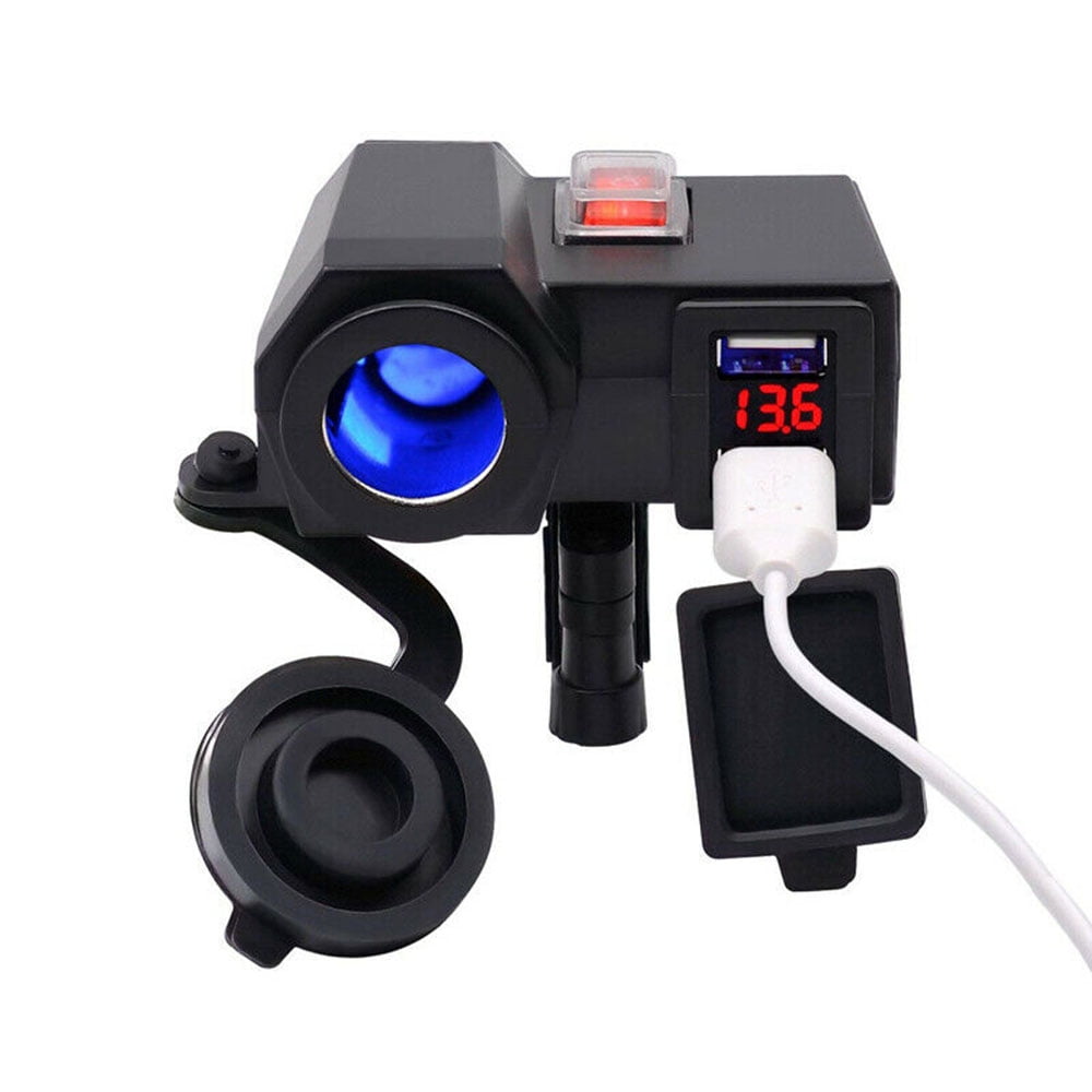

What I would have done (what I have done, in fact, for electrical accessory mounting) is to replace the stock handlebar clamp with a two-piece unit from a Shadow that uses a 1" diameter bar:
https://i.ebayimg.com/images/g/k6QAAOSwwTtgB3Q1/s-l400.jpg
Then install one of these between the riser caps and wire it up:
No muss, no fuss and no drilling required. If you scour eBay often enough, the chromed Hondaline riser caps occasionally show up for sale.
