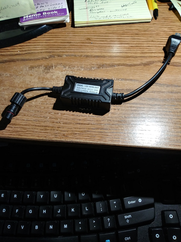

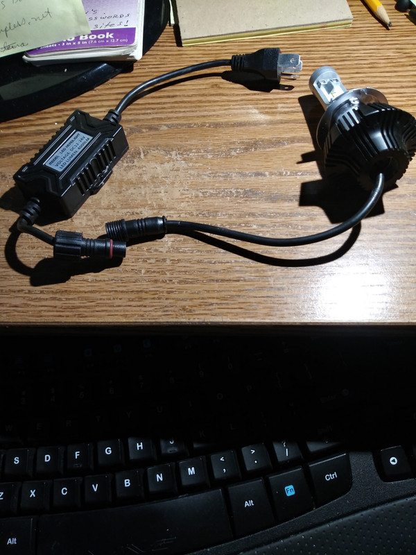

Got 2 sets of the H4 headlight LED's from a friend in Florida and they worked great until last Wednesday when the left one crapped out. After removing the bulb and the little box for it, I tested it on the old bike. The bulb lit up but very dim so tried another new bulb from the same package with same results. As a further test, I plugged in a new box(think they're a load resistor) with the crapped out bulb and bingo...eye burner brightness. Eventually it narrowed down to the box was no good. So here's my problem, there's no name anywhere on the box or material inside so I'm stuck unless I can find a duplicate. I installed the new spare unit in the I/S so I do have both headlights, but my son-in-law wanted to install the additional set in his I/S but now it's lacking the load resistor or whatever that thing is. I see all kinds of these boxes on Ebay but only with a plug in connector, not a screw on collar as seen on the short end lead. Any suggestions, I removed the bottom cover on the box and it's a sealed unit so unable to birddog it for possible visible failures.

Mike, I find all kinds of load resistors but none that will work with my bulbs. All I find on Ebay have plug-in connectors on both ends. As you can see in the picture below, mine have a screw on collar and I haven't found any like that. When you remove that heat sink, there are no blade type pins to be used...just the harness coming out the bottom terminating with the collar as seen. Am I missing something, I copied/pasted your search reference on Ebay and it came up with no matches.
John, I know exactly what you are talking about, because I have the very same bulb laying on my shelf.
Screw type automotive connectors for the LED driving box (aka ballast) and so on.
Here's the shop where I bought from:
https://www.ebay.com/itm/274831685756
Not sure if these will ship to US, though.
If you were in Germany, I could send it to you for shipping costs only. To US it wouldn't cut it unfortunately (see 2nd link below for cheapest solution)
Another quick search on Ebay and I came out with local offers:
https://www.ebay.com/itm/282830170899
https://www.ebay.com/itm/172220390746
BUT - the question is: Why are mine on the shelf...
Because I didn't like the fact that the drivers produce RF noise I was able to reduce by 3.5mm ferrite suppressors just to some acceptable level.
