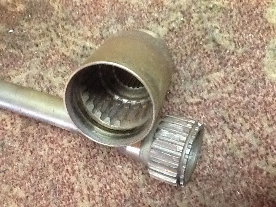

Here's the Honda Special tool listed in the Service Manual, I
think it works great...
They have this other mallet-related tool for removing the bearing...
