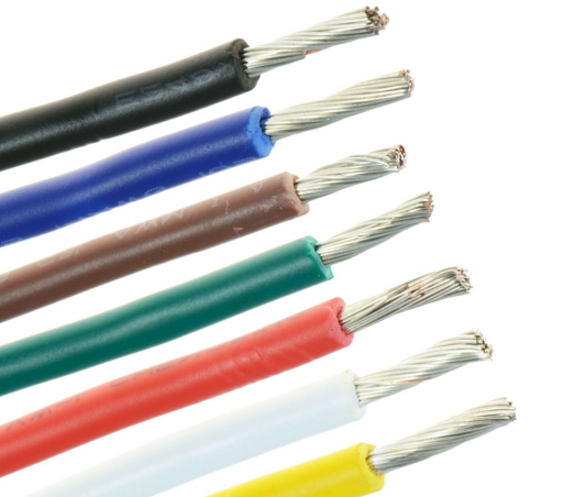

Anybody know a disadvantage of using these extra thin stranded wires?  They're advertised as automotive wire.

Anyways, I'm dissatisfied with the stranded electrical wires at Home Depot, etc. For instance, a 14g should have 19 strands but the 14g at H.D. have less strands and the strands are thicker. Thicker strands are stiffer making them harder to splice together. If you dissect a Honda wire, you'll find they have more strands than store bought wires per given gauge.

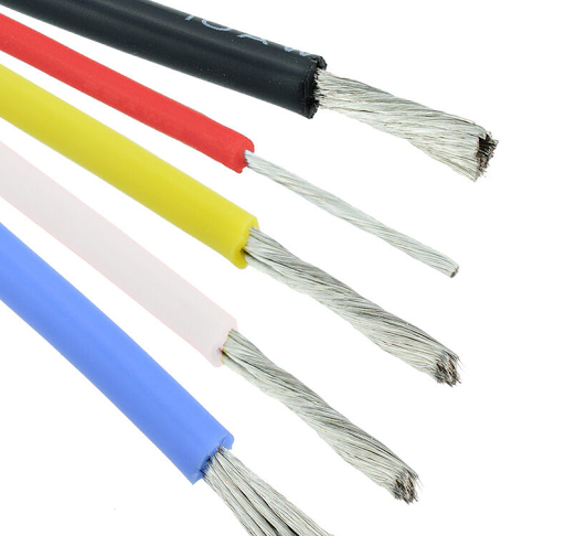

The thinner strand wires I'm talking about have a silicone jacket. They're even referred to as silicone wires for whatever difference that makes. Also, individual strands are tin coated in silicone wires. So, I guess they're better logically.
On some of them the strands might be too thin.
Something like this is ideal. The wires pictured are silcone wire because the strands are tinned.
