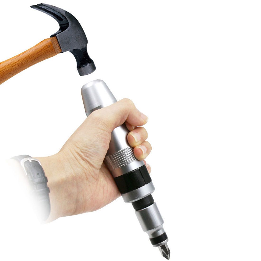

if you ordered oem screws and have to do the clutch reservoir, you might as well buy the JIS screwdriver. Somebody suggested an impact screwdriver driver. It turns counter-clockwise with each tap of the handle. It's a wish list tool that I still haven't bought myself.
I have one of those for brake rotor screws. I have never tried that tool on a smaller screw, not sure how well it would work. ??? I really can't think of when I used it for anything else?
Yikes!  I wouldn’t let that jack hammer anywhere near my wheels. I can’t think of a fastener on the Bike that should need such overkill. For brake rotor screws just use a breaker bar. They are not that tight
+1
They're retained by the equivalent of our blue Loc-Tite (not sure of the Japanese formula designator for non-permanent mixture). Gently heating the bolts with a heat gun should be all that's needed in the way of additional persuasion past the use of the breaker bar.
Sorry I meant for a car or truck not a bike. I would never use that on a bike for anything.

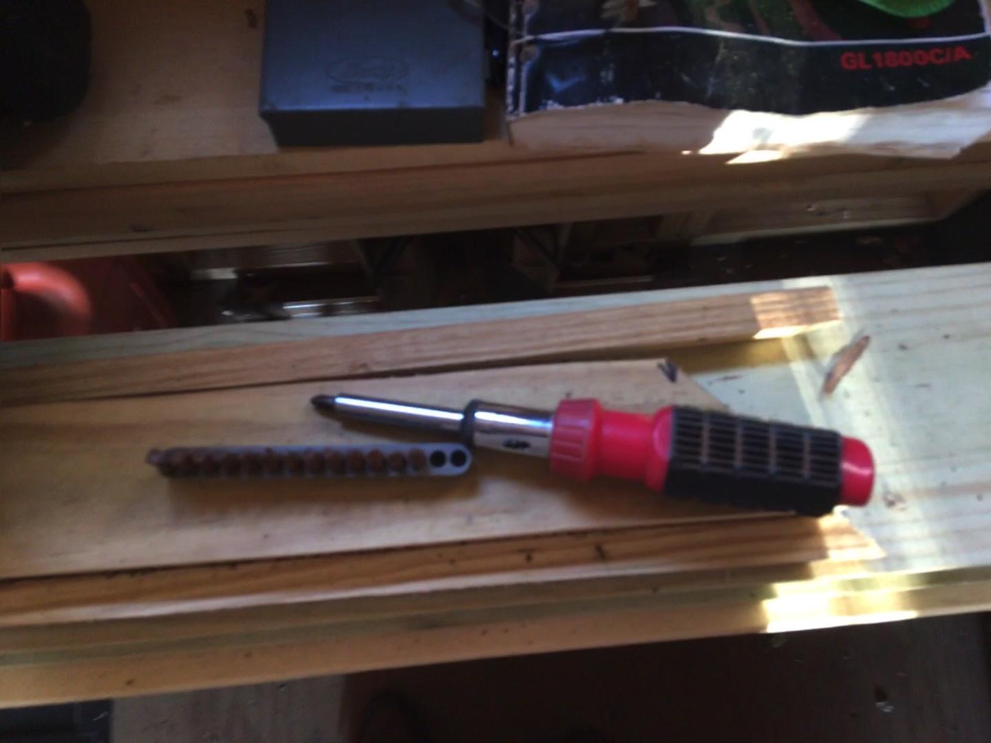

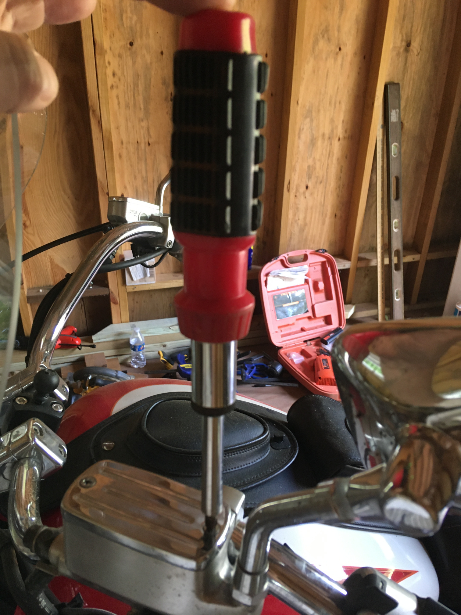

I have used the manual impact driver numerous times on the master cylinder screws. I use a 3 pound mini sledge hammer and just TAP it. Whaling away at it will only screw it up. (a pun?)
