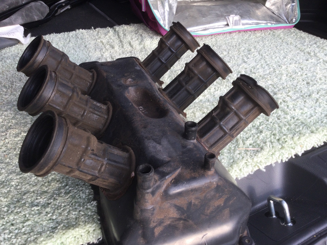

With the tank off and the air box out, some of the previous back yard mechanic mistakes are coming to light as well as some much needed maintenance.
These intake tubes were folded in and are now beyond salvaging.
