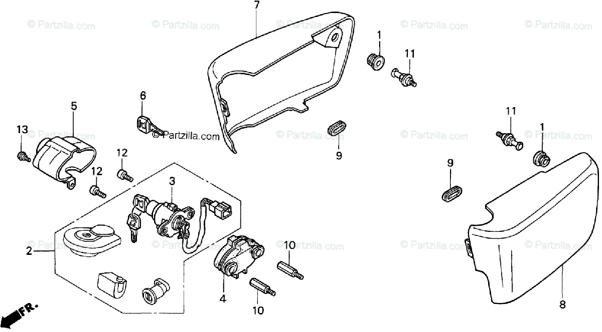

In the following example the side covers have part numbers shown but the grommets don't...only shows them encircled with a F-25 code. How do I find the part numbers for the grommets based on the F-25 code?

I'm going to make an assumption.  The F-25 is a package of grommets.  You can't buy just one.  That low price certainly cannot be for the cover itself.
That's not the side covers:
https://www.partzilla.com/catalog/honda/motorcycle/1997/gl1500ct-a-valkyrie-tourer/side-cover
They don't look like the plastic neck covers either... ida know...

We don't know what parts fishe website that is.  Otherwise, I would have looked for you.
The first thing to do is back out of that sub-parts section, and see if they have an F-25 parts section.
Or, a section (probably near the end) with miscellaneous small parts, one of which is F-25.
Someone just posted a link to an aftermarket seller, on Amazon, that had all the Valk sidecover grommets in a package for like $7-8 dollars.  Here you go:  https://www.amazon.com/Show-Chrome-Replacement-Grommets-52-691/dp/B0012TYYKU
And I agree with Grandpot, if that site is listing side covers for 10 bux, go to another site and start over.
Here's the one I use:  https://www.procaliber.com/oem-parts?aribrand=HOM&arian=MOTORCYCLE
The was only an example and is not for a Valkyrie.
I come across this situation on Honda schematics for my other bikes too.
Yes the side covers are priced correctly.
The grommets are available separately.
Here is the link to the example https://www.ronayers.com/oemparts/a/hon/5c2fcb7e87a8660b98794366/side-cover
Backing out of the sub-section does not show a F-25 parts section.
The side cover grommets are pictured and part numbered in the air cleaner schematic....parts 15 & 16  https://www.ronayers.com/oemparts/a/hon/5c2fcb7e87a8660b98794369/air-cleaner
The point is I want to know what does the F-25 code signify or how does it get you to the right schematic to get the part number?
I should have noticed that.   crazy2   I was only looking at those grommets.
I can't remember seeing any of those side-code (F25 type) parts in any Valkyrie schematics.
A Honda bike dealer parts man might be able to explain it (them).

Just to get you up to speed on this thread...the side covers in my post are for a Honda CMX 500 and were only used as an example of how Honda sometimes displays parts in their schematics for various bikes...in this case it was side covers with part numbers shown and grommets with no part numbers shown but were encircled with a code F-25.  The point of my post was to find out if anyone knew if the F-25 code could be used to get to the right schematic for the grommets to get the part numbers.

I posted my inquiry on another forum and found out what the codes mean....certain parts lookup sites have the schematics coded.  In my example F-25 indicates the air cleaner schematic...and as I already knew the grommet was shown there along with part number.  Now I know what the codes mean and can get to the right assembly when I run into these codes again.  In the dropdown box there was 58 codes.

As I posted above the coding corresponds to a specific schematic.  In the example the grommets for the side cover are not part numbered in the Side Cover schematic but are encircled and coded F-25.  This means the grommets are shown and part numbered in the F-25 Air Cleaner schematic.

Sure it doesn’t give you the Honda part number but the kit from ShowChrome looks like a match
