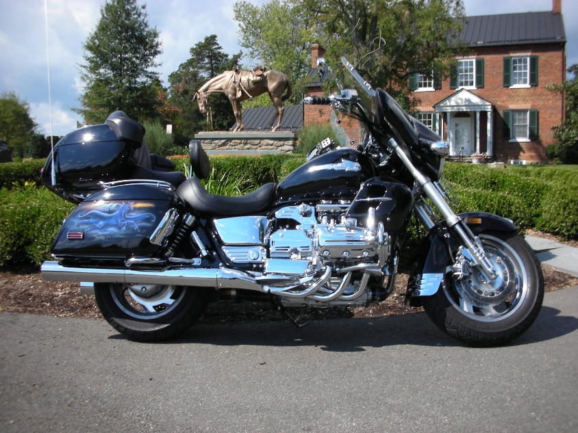

I just have stock exhaust with 18" flat cut truck stack tips in replacement of the stock tips.
One bike is bone stock, and the other had the piggies cut off when I bought it.
I've never had the urge to change anything else at all.  My carbs are stock, but both bike are fully desmogged.
I rode a Hog with aftermarket Pythons for 18 years (not straight, but baffled, but quite loud if you goosed it) so I already had loud noise out of my system when I traded up from Harleys to Valkyries in 2005.  I like a little rumble, but no more.  I don't like cops hearing me coming around the bend and flipping on their radar or lidar on me.  And the Valk cannot be significantly powered up with any other exhaust, the OE is quite efficient.

Here is what I'm changing mine into.
It's just 4" truck stacks replacing the rear chrome. In my case, I replaced the whole 4" length. Some just do the 18" tips, get rid of the taper.
Mine because the pigges where cut off.
msb bike looks the same as mine, but he has replaceable glass packs in his. He can change them out.
We both have these 4" slip in marine baffles.
https://www.hardin-marine.com/p-12622-4-slip-in-silencer.aspx
Leave then in to keep the bike quite. Remove for the noise.
