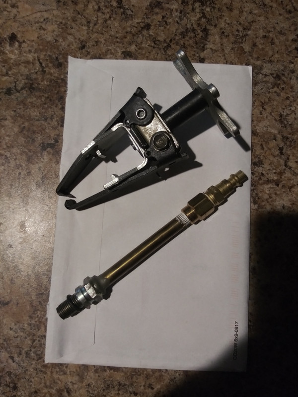

I made my own air injector using an old spark plug and knocking out the ceramic center portion. I then sealed a short piece of pipe into the gutted spark plug with JBWeld, the pipe is about 4" long and threaded on both ends but only needed on one end to attach the air line fitting. The entire thing is only about 7" long and worked well on a number of occasions. I've used it a number of times replacing seals on old 4 cylinder Gold Wing motors that happened to have fairly low miles but sat unused for many years. When used, I just roll the cylinder to be worked on up to TDC, inject low pressure(doesn't take much), then go about compressing the spring(s) with the other tool just enough to remove the keepers. I found it a bother to have the air injector hose left in place while removing the valve springs so found a cut off valve I could put on the air line hose end of the tool before attaching the injector. That way I was able to fill the cylinder with air and remove the hose. The picture is from before I replaced that connection with the cut off valve...I looked but apparently never took a picture of the tool with that conversion.
