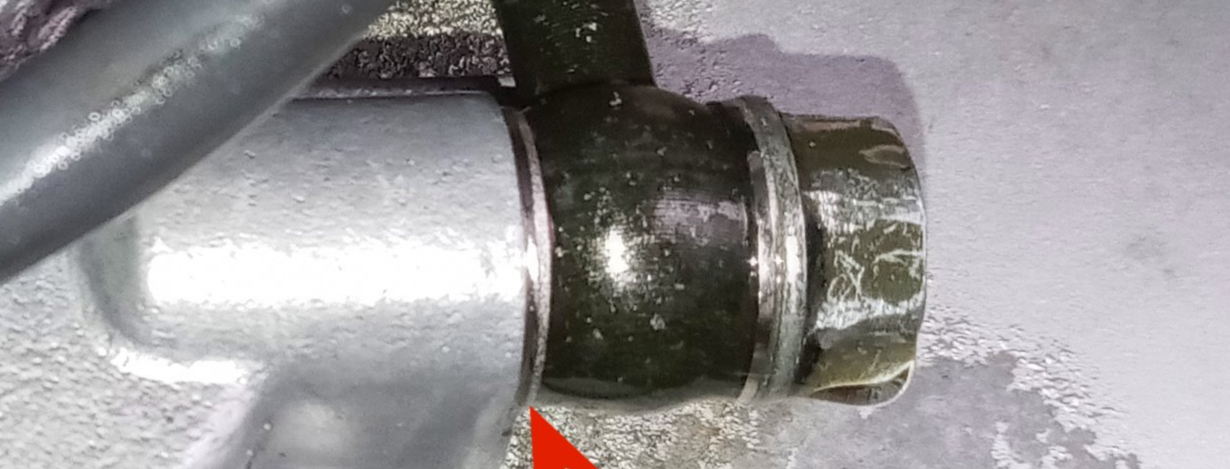

Got around to finally replacing slave cylinder. Installed and then reconnected all lines. Started bleeding and kept getting leak at the hose connection shown below. First was near the top of the bolt, now it's where the crush washer meets the body. Both crush washers are new.
Anyone run into this before and if so, how did you fix it?
Could it possibly be the new body has a crack in it at the connection location?

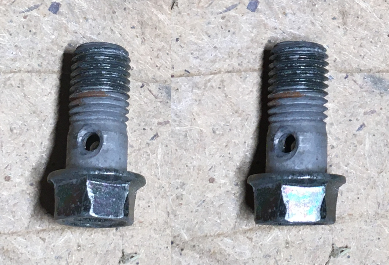

That's one abused banjo bolt! If brake fluid can find a place it leak,
it will. Maybe if you put the right wrench on a new banjo bolt you
could tighten away the leak?
No sir, there's nothing wrong with the bolt head. Loosened and tightened with no issues. I think you're just seeing where the paint has come off.

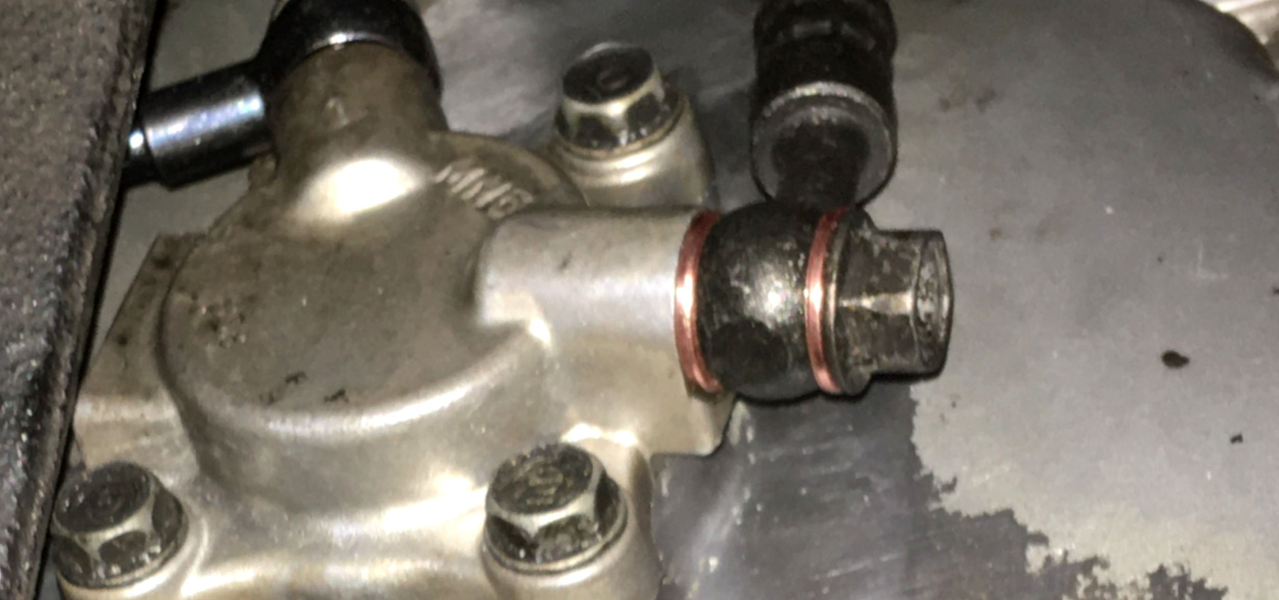

I guess those bolts are kind of funny looking anyway...  I don't have a new one...
I had to refurbish my slave cylinder this summer, I took this picture when
I was done...
And your picture:
It is a bummer to have to release all the fluid by taking that back off,
but if it is leaking there, that's where the problem is. Like meathead
mentioned, a bit of grit, some kind of burr, something right there. I feel
like I have to really tighten down on banjo bolts to prevent leaks... I
have copper crush washers because that's what NAPA had to sell me.
Are you sure it is leaking there and not running to there from someplace
else?

That's what I'm planning on for this upcoming weekend. Going to check all parts for any damage and try to pinpoint the leak.
