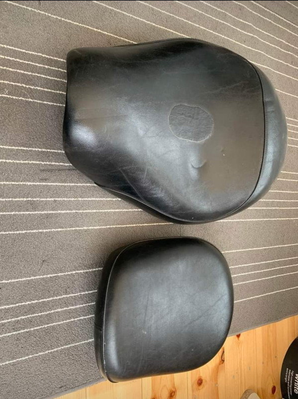

From what I can gather, the later seats, I think from 2000 on, are more comfortable.
I've seen this pair for sale.
Can you tell if they're an early set or later set please?
I'm aware that the driver's set needs recovering.
Also, can you tell if the underside has any damage, in the picture?
It's described as coming off a "2000" but I'm wondering that due to the fact that the passenger seat says "Made in USA" suggests it's an early. Still, I may be wrong.
Thank you

pre 2000. Don't pay much Partzilla has new post 2000 (the thick one) part no 77200-MZ0-A80 for $121.76

Ya that’s an early one for sure and not very at that

The old pillion will fit fine.  If you rarely take a passenger why change it?

The old back seat says "Made In USA" on
it. I run my bike solo, and occasionally with
an Ultimate back seat, but if I was going to
have an OEM back seat mounted to my bike
all the time, it would be the older one  cooldude ...

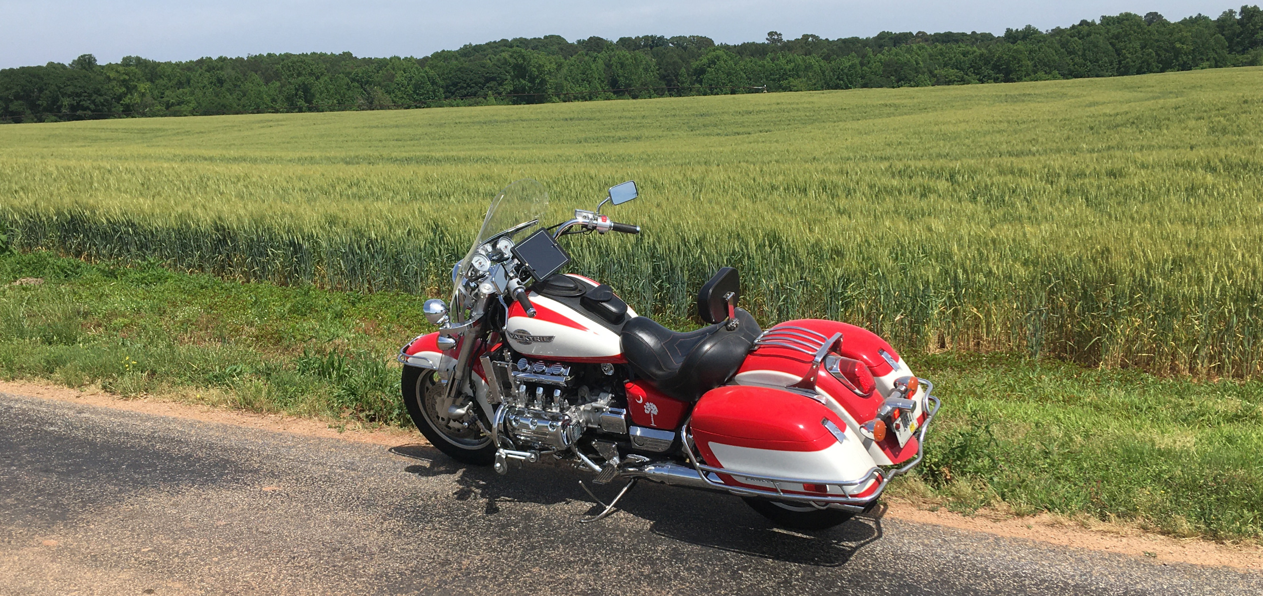

I tried a russell on my bike for a while, here's
a picture of it with a Utopia back rest... the Utopia mounts
to the same two front holes as a rack or a rear seat.
The bending danger occurs when you run solo without
the curved rear fender rack, or a seat, to spread the load.
« Last Edit: November 01, 2021, 07:18:02 AM by hubcapsc » Logged
That's great. You're quite right. I only take a passenger when my daughter stays with us a couple of times a year. She lives in Sweden and is already in love with the Valk. I just thought there may have been a mis-match with the fittings. All the better as my cost is just the one seat. Thank you.

rear pillion seat with USA on it is rare only made the first 1-3 yrs.

« Reply #12 on: November 01, 2021, 10:12:53 AM »
Post 2000 seat now ordered. Thank you all for your input.
