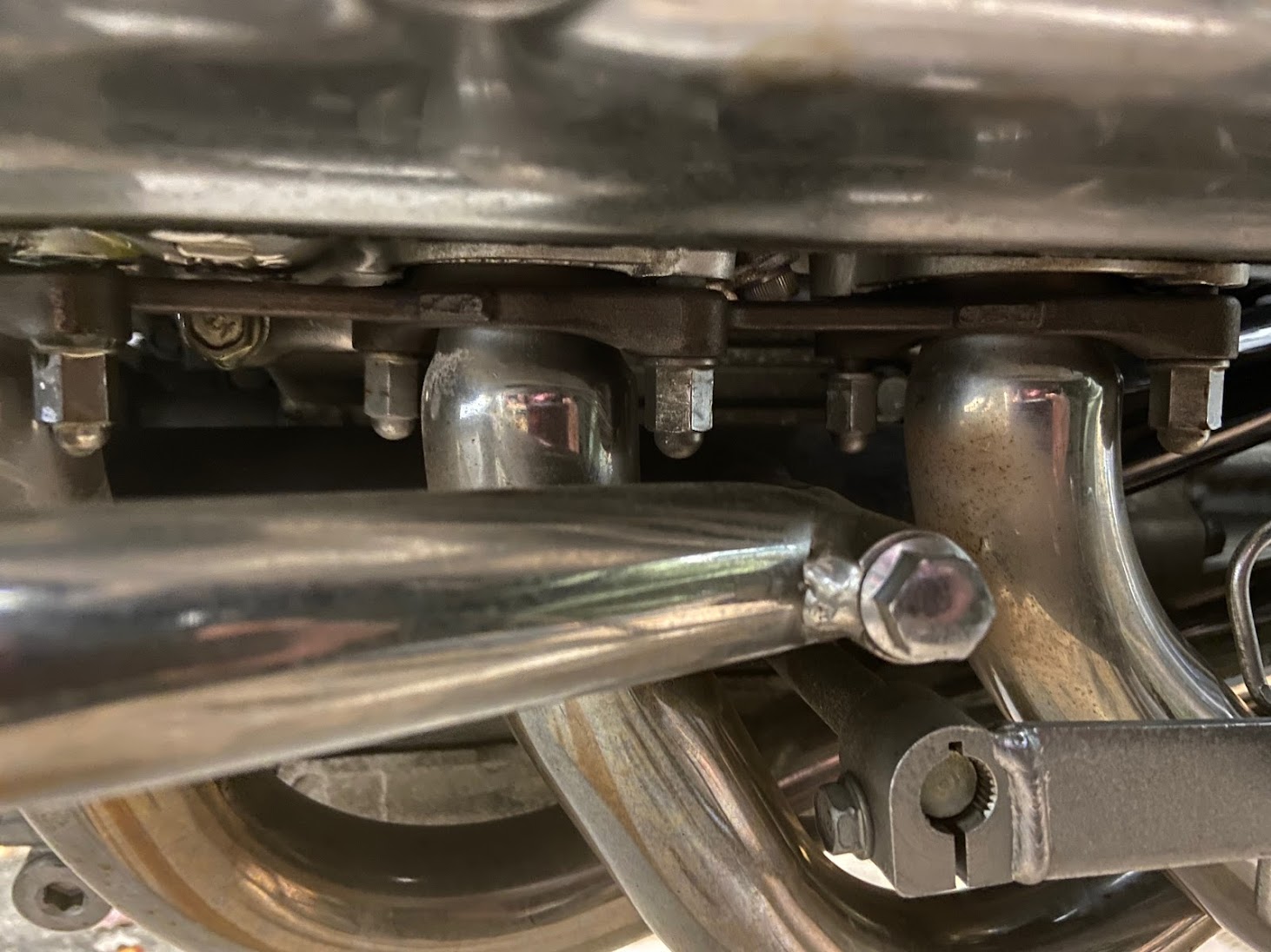

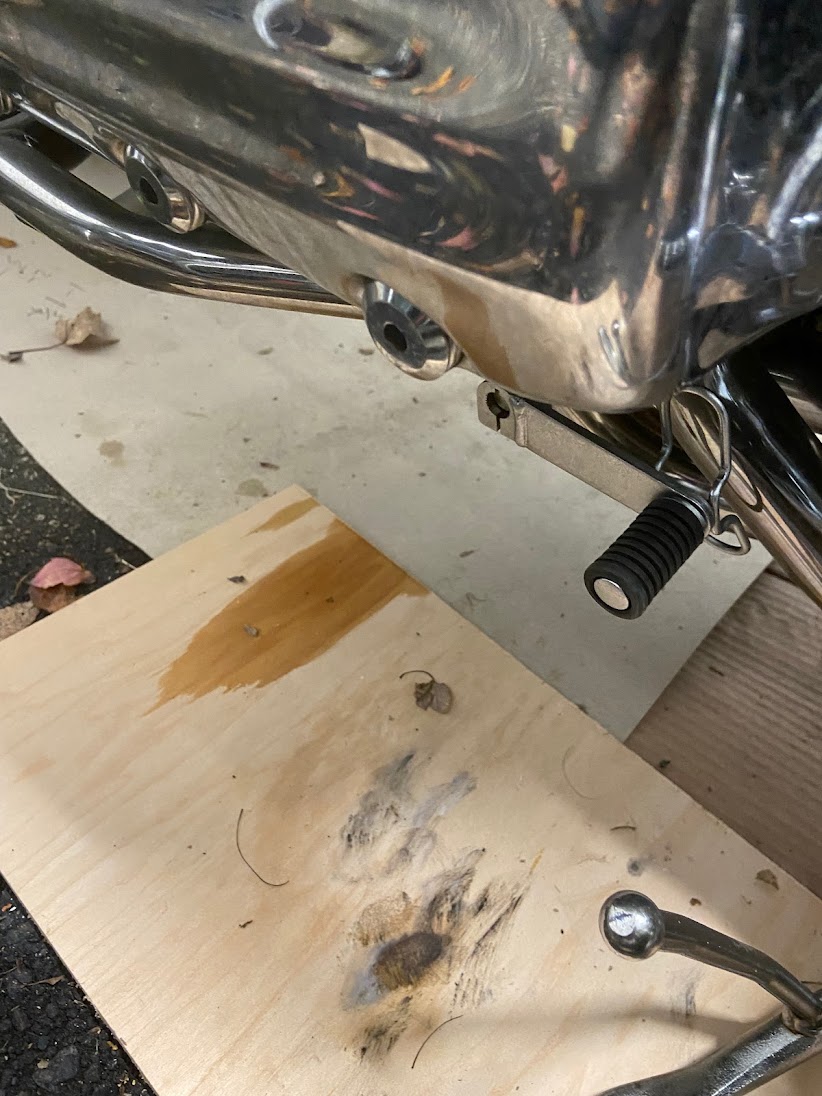

I'm restoring a 1999 Interstate that my elderly Dad gave to my son for his 18th birthay. It's got 81K in mileage and has been in every state in the lower 48 when he was riding, so it was well taken care of, and more importantly for these bikes I'm learning, riden.
It hadn't been ridden in at least 7 years, so the tank was rusted and after that hurdle came carburetor cleaning, oil change, coolant flush, brake & clutch flushing, final drive change, new brakes and the tires are arriving today. It runs well now, but I did notice a leak yesterday on my leak detection system.
It's coming from underneath and pooling on the exhaust manifold bolts. Feels slightly oily, and is light colored. I tried to take pictures of the area it seems to be coming from, but not sure I got it.
Is there a common failure that this symptom points to?

Look on top of the head, is there brown fluid around the base of the intake manifolds?  You need a hosting site to post a link to your pictures. Many use POSTIMAGES. It’s free

You tried to post link URLs as images. I clicked around on them and
have the images here:

Does the valve cover gasket area feel wet?
Posts: 14918
« Reply #6 on: November 03, 2021, 11:21:09 AM »
Because it’s on the low side (left) that’s where coolant ends up when the top hose at the thermostat leaks. Use a flashlight on the left forward of the carbs to see the thermostat housing. If it’s shiny it’s wet and could be the issue.

Thanks all - it's a coolant leak. The radiator fluid is down below the neck by about two inches and I can see coolant on the engine on the low side by the head.
Have to install the tires and front fork seals, so I'll tackle that when the front end is wide open.
