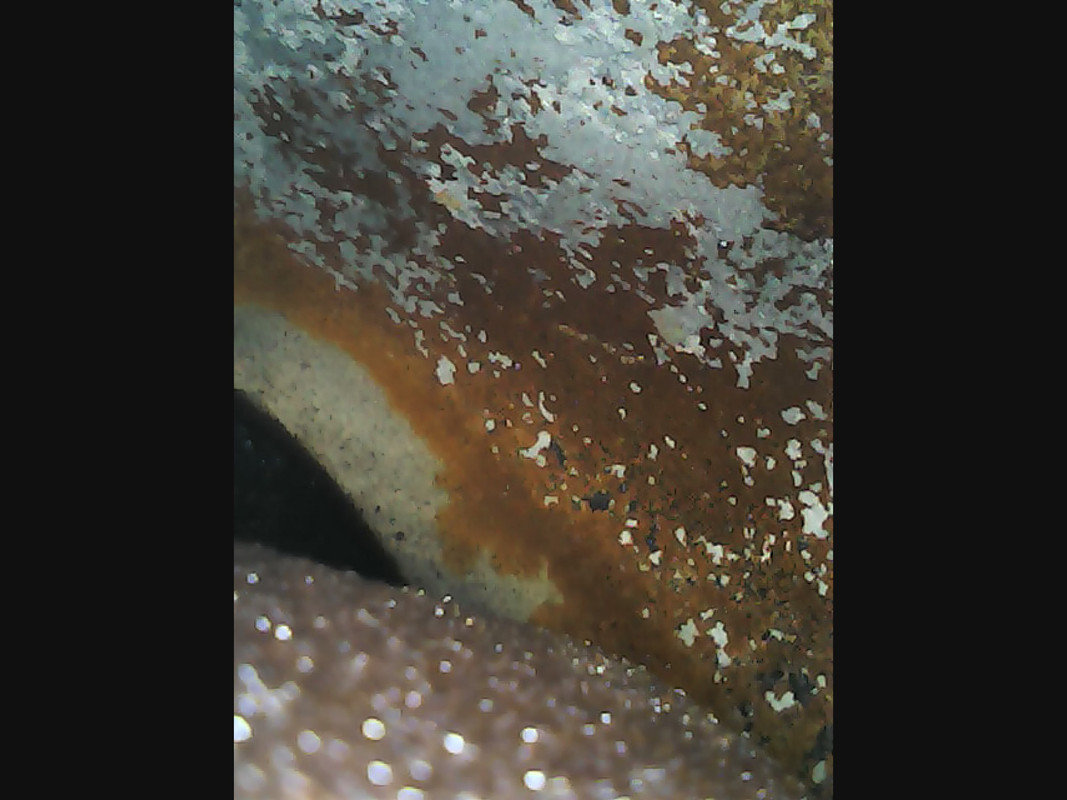

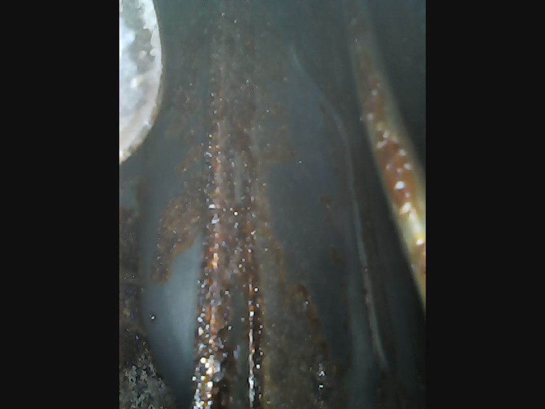

I've poured in 20 litres of Evaporust from the filler neck after plugging the two bottom outlets.
I would say there's room for another litre and do at some point I will be inverting the tank rather than swilling it around every hour.
I shall check the tank in the morning which will be around 14 hrs from filling up.
After probing around with an endoscope I'm pretty happy with what just appears to be very mild rust.
This is a '98 bike with 13,000 miles which isn't a lot so my guess is it was parked up a fair bit of the time.
I'll post further pics of the next stage....

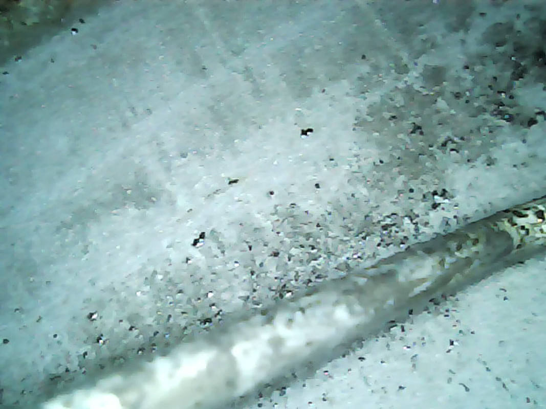

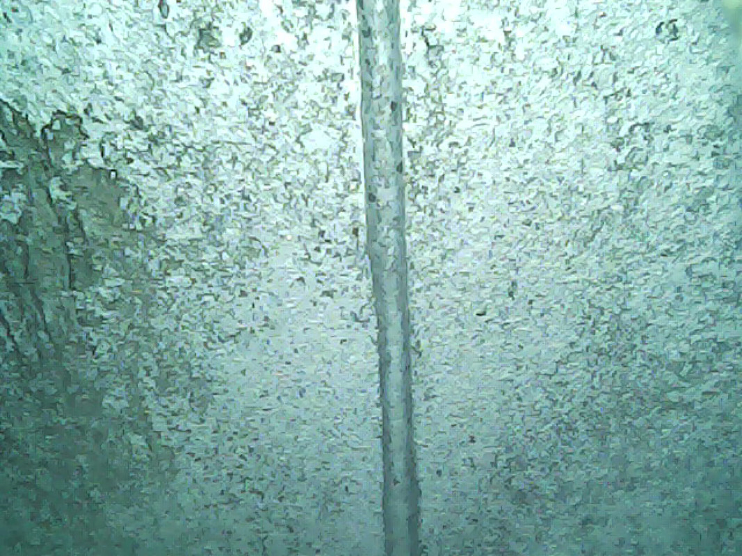

« Reply #22 on: November 20, 2021, 03:33:32 AM »
After 48 hrs with a 12 hr tank turn over in between (only because I was about 500ml short) these are the results..
If you look at pic 4, by peering into the tank, you wouldn't think there was a problem.
Some parts are fine but I can see enough rust for me to continue the treatment.

« Reply #23 on: November 25, 2021, 09:34:36 AM »
Just for the record, this is the scenario after one week of Evaporust....
I then flushed the tank out with water and kept shaking it until there was little or no water in it.
I then swilled a litre of Methylated Spirits around,  drained and skilled a couple of litres of petrol.
Once drained I gave copious sprays of Fogging Oil from both orifices. The bluish pic you can see is a pic taken with Fogging Oil wafting around...
Looking at the results I would have no qualms about recommending Evaporust though be prepared to wait a week.
