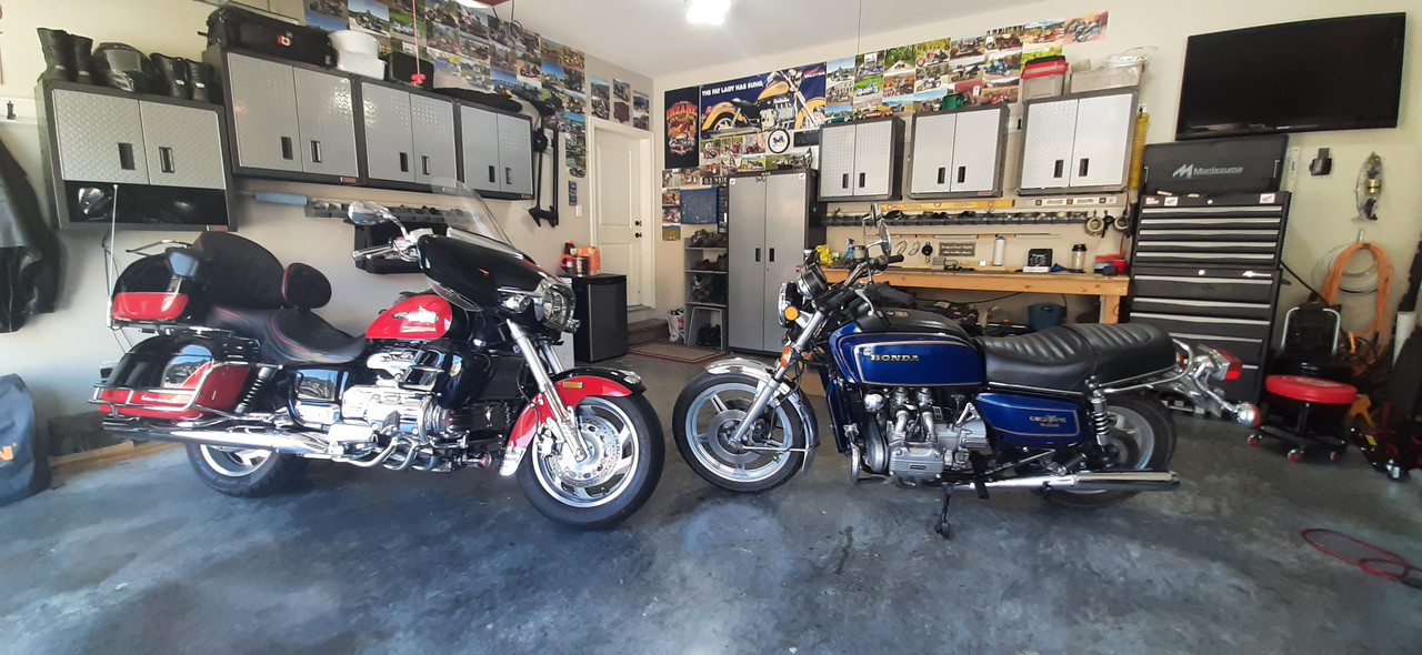

While I am up in Canada, Winters here in my area of BC are quite moderate and relatively short compared to other parts of Canada and many of the Northern States. I've had my Valk for 20 years, and used to do a similar full winterization on it and pull it off the road for a few months way back when the kids were still at home and I had lots of other stuff going on. Over the past 10 years or so though, I haven't done a full winterization when I pull it off the road (usually for 3 months now), preferring instead to just run the bike either around the neighborhood when weather allows or just in the driveway, bringing it up to operating temperature... at least once or twice a week. I do make sure it's got a full tank of "good" gas when it goes off the road and a recent run with Seafoam (also in the first tank or two of gas in the Spring) along with a fresh oil change, etc. I also do other annual maintenance items like the rear drive service especially, during this time. It's stored in an attached insulated garage on a battery tender in between startups. So far so good....about 200,000 km on her and haven't had to rebuild the carbs yet, and I average about 6 years out of my Yuasa batteries. I'm sure the carbs are due for a good internal cleaning and eventual rebuild sometime in the not too distant future...I'll probably have that done sooner rather than later...before I start experiencing noticeable issues.
Also have a 78 GL1000...this is my Winter bike. I do more or less the same as I do with the Valk, except that it stays insured all year long so when days pop up during the December thru February months when weather and road conditions allow, it gets ridden as regularly as possible (would guestimate at least 6 - 8  times a month on average). Have only had it for 2 Winters, but again, so far so good.

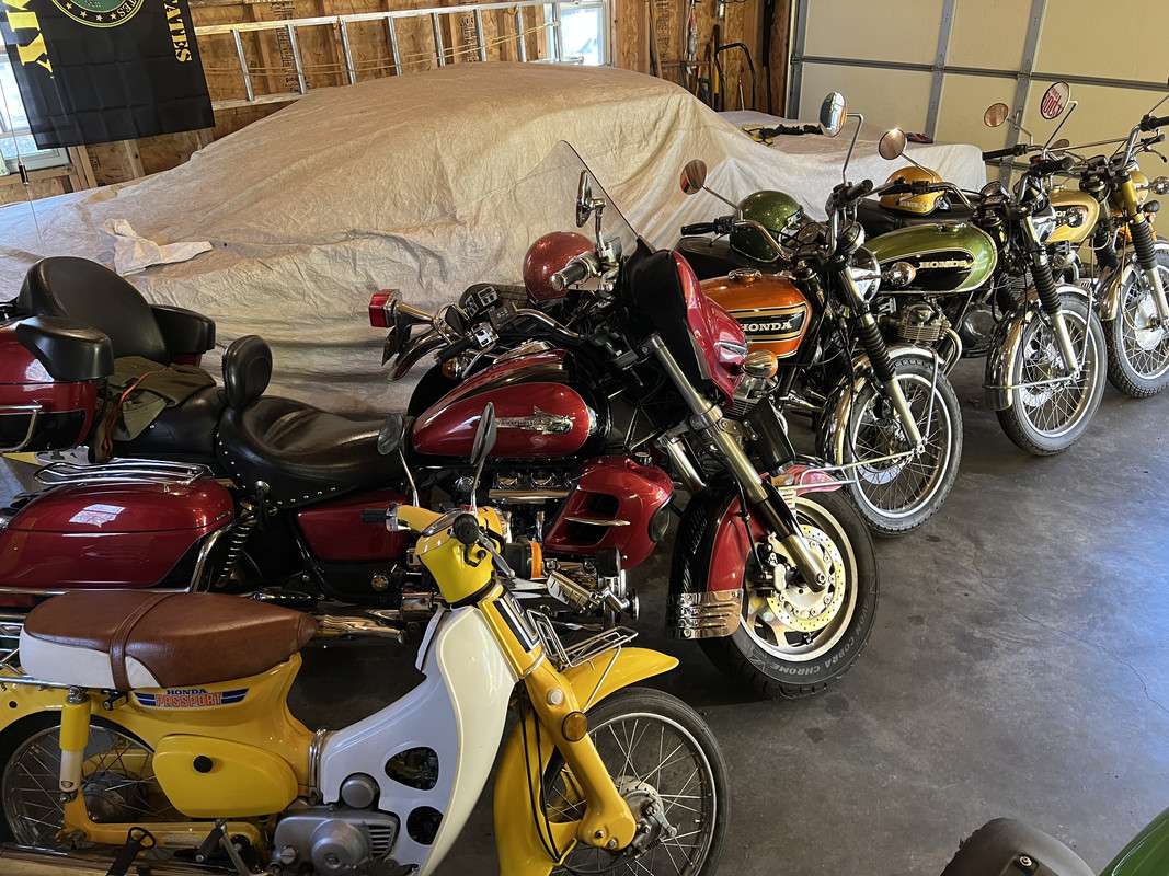

@Oldfish: all good advice.
In a side note: what an awesome collection of Honda motorcycles!
