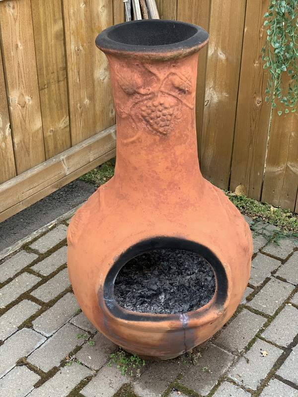

Man I love this thing!

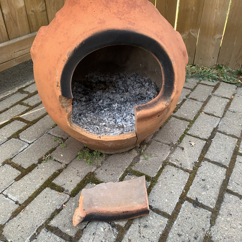

Just perfect for our needs but I made the mistake  uglystupid2 of burning birch the other night and I think it was just to hot. As I sat there enjoying the burn a chunk just fell out  Huh? so now what?
Any ideas on how I could fix it would be appreciated or maybe it’s a lost cause…..I don’t know. Im off to Home Depot to see if I can find something that may do it.

Just thinking out loud, most pottery is fired at much higher temps than just a wood fire. I would think it was a defect in the piece itself.

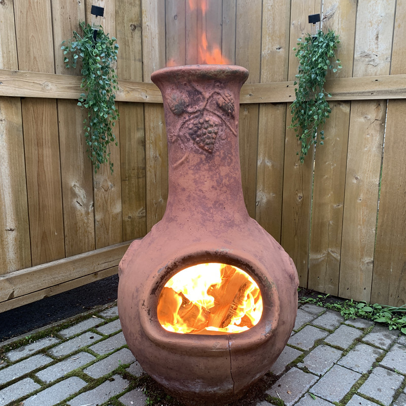

Burning too hot I think, you have fire coming out the top. That appears to be a pretty strong fire for that kind of device.

it appears already cracked in the middle had a weak spot in it to begin with
« Reply #8 on: November 13, 2021, 07:15:24 PM »
Stack 2 blocks where the piece fell out and burn it Grin

Has it been rainy or real damp where you are? Has it been cold, freezing?
When these became popular here in NJ a couple decades ago, this would happen quite often, I can see a crack on the right side of the first photo while the fire is burning. These will absorb water and crack if it’s too cold. When not in use keep them covered or in a shed. Also it should have a retainer ring around the base so it’s not sitting directly on the ground, let the heat dissipate from the base.
When it’s real cold start your fires small for a while before you really get them cooking.

Trapped water in a crack will build up steam pressure and you will hear it hissing then pow something is going to give. Had some rocks around a fire pit that had cracks and when it blew it was rock shrapnel all around. Also looks like a crack from a drop.

You guys are right, it has always had a fairly wide crack in it since the day it was given to me. Friends had two of them just for decoration. I have never shown any mercy to it as it has alway sat exactly where it is now for at least ten years or more. Never covered, -20 full of snow even buried in it and I’ll have a rip roaring fire in it! Always use pine but this last fire I used birch I
got from dead branches from my sisters tree. I figured it may have been to hot. Most likely just coincidence and I guess I deserved it from all the abuse it gets. I’ve seen the stand for them but never liked the look. Might be a good idea though.
