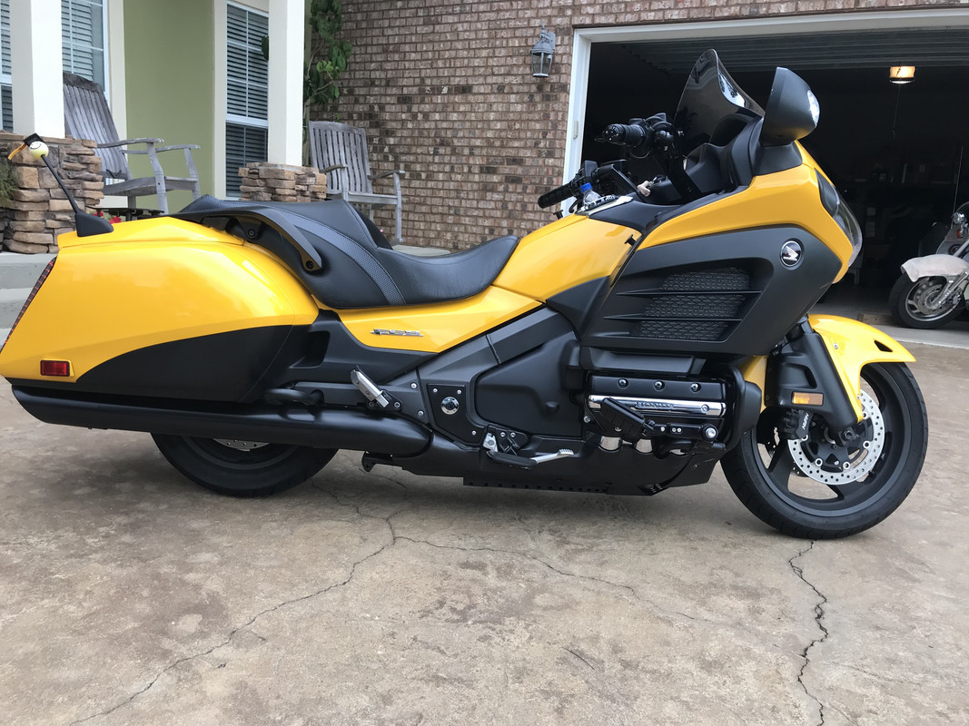

  smitten love Stinger my beautiful Yellow/Black 14 F6BD I bought w/ 8k in Jan. 2020 now almost 20k. I split time w/  Renegade. As I understand it the D model has the Ctr. stand, self canceling blinkers, foglights and heated grips. As it was stated earlier the 15 & 16 had the factory cruise which I wish I had Roll Eyes. I put a belly-pan on mine to help protect the bike. Little more work when I have to change the oil but ok with it. The oil change is not difficult at all. I was out on Stinger today in fact. The 13 & 14 bikes came with the chrome exhaust. I bought a like new set of black pipes from a fellow F6B in CA and put them on my Stinger. She has NO chrome and looks better that way. I haven't seen one like mine which I like. Y/B are hard to find they only made that color in 14. Great bike for comfort of course but the extra power response is a beautiful thing coolsmiley It came with a Mustange seat that I sold on the F6B board after I found a like new Ultimate off the same board in TN. I'm all set other than adding the Throttle Assist I just bought.  coolsmiley
Unique for sure...never even knew they made a Yellow/Black, much less seen one. I agree they look better with no chrome...which folks who know me would think is odd, coming from one who has spent 20 years adding and polishing all the shiny bits on his 1500.
Belly pan....lot of off road riding there in Florida? Wink

"Belly pan....lot of off road riding there in Florida?"
Quite a few owners of the "B" have put a belly pan on the bike to protect the coolant overflow container, which is in a vulnerable position, from being damaged by any road debris being thrown up by the front tire. I don't know if it has actually happened to anyone, but that's why it's done.
Right you are six2go. But also may come in handy when the creeks have risen! I can skip across Cheesy
