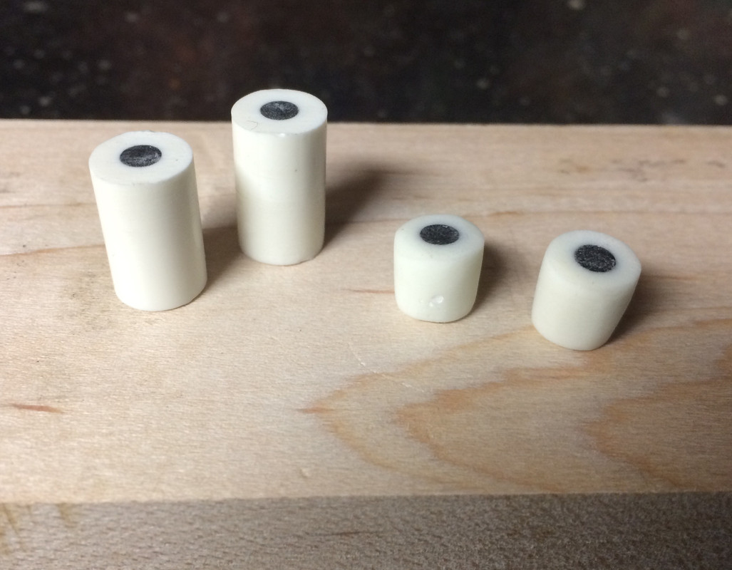

I use a lot of epoxy resin in my furniture repair. So for Marlin rifles with the bullseye it’s not uncommon that they are lost and need replacement. So I figured out a way to make them.
If anyone here has a Marlin missing its bullseye. I’ll send you one for the shipping.
First I had to get white and black pigment for the resin. Then mix up some white and draw it into a syringe.
Once hardened. Just cut the tip off the syringe and push the blank out.

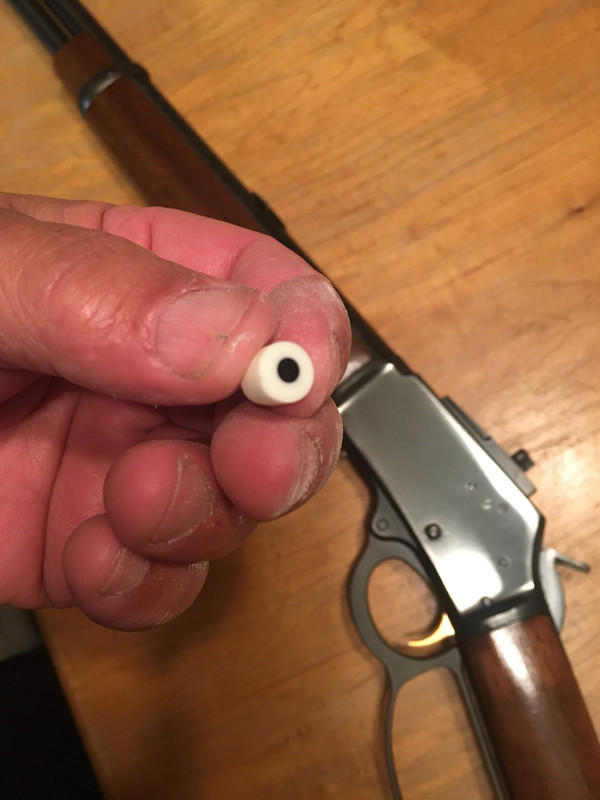

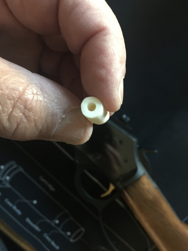

The hardest part is getting a hole drilled right through the center.
Then fill with black resin and cut and size for installation.
This is how much bullseyes stock I have. Enough for 6-8 inserts.

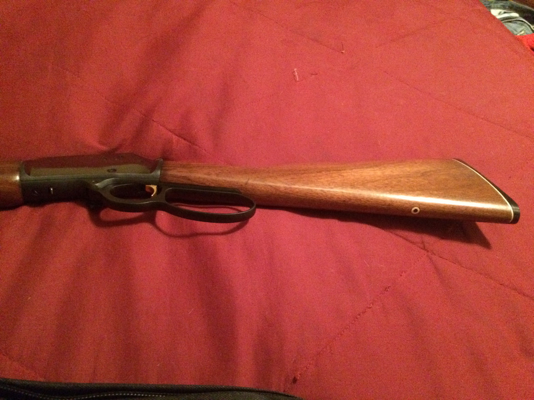

« Reply #1 on: November 18, 2021, 04:16:04 PM »
Sorry, but where does that go on the rifle??
A bulls-eye is on a target.
Posts: 14933
« Reply #2 on: November 18, 2021, 04:33:42 PM »
Posts: 31182
« Reply #3 on: November 18, 2021, 06:24:18 PM »
That looks like a spot to mount a sling swivel, no?
My 1896 is in the back of my safe and too much work to get to.
I never wanted a sling on mine either.
Posts: 14933
« Reply #4 on: November 18, 2021, 06:49:05 PM »

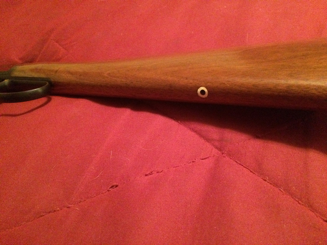

Sadly people do think that’s the spot for a sling swivel. It’s not, the sling mounts a couple inches aft of the bullseye. The Bullseye is a trademark identification marker so a Marlin can be spotted next to other brands.  Some Marlin owners look for replacement bullseye inserts after wrongly drilling through theirs for a swivel. If the drilling was clean a repair can be perfect.
