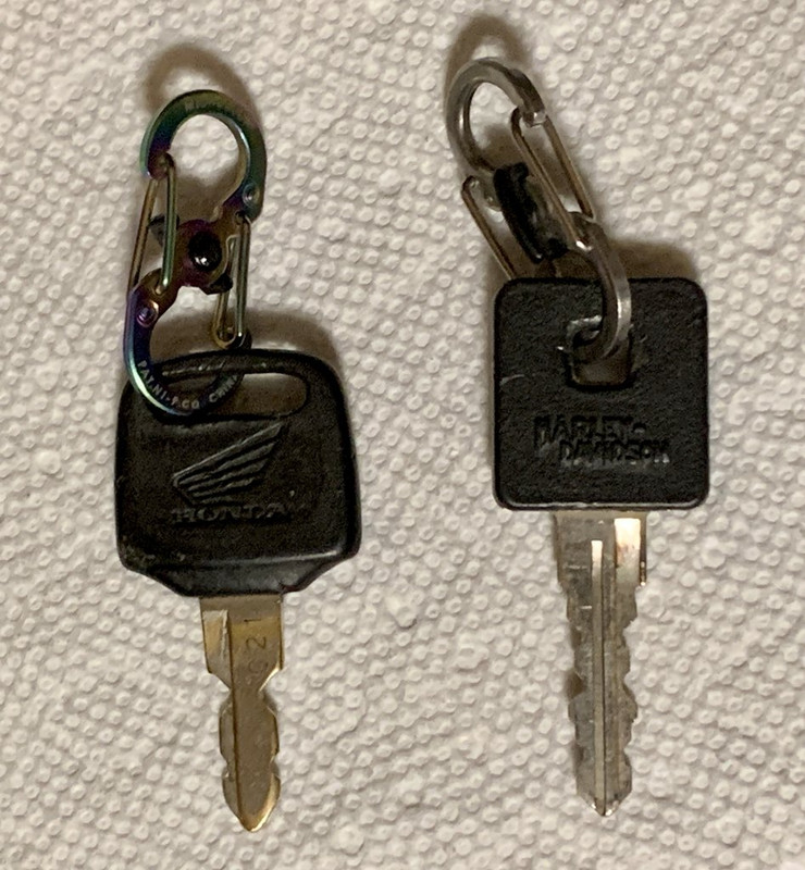

Something else I do is use these little S-Biners so I don’t have my full, heavy key ring jangling around and potentially damaging the lock mechanism. You just need to be a little more aware of removing the key when you shut down.
I have another helpful hint. Remove the key less. There are very few places I go where I actually remove it. Just leave it in. Been doing it for twenty years so there’s really less than ten years of key removal. Probably closer to five years of key removal on my ignition switch
