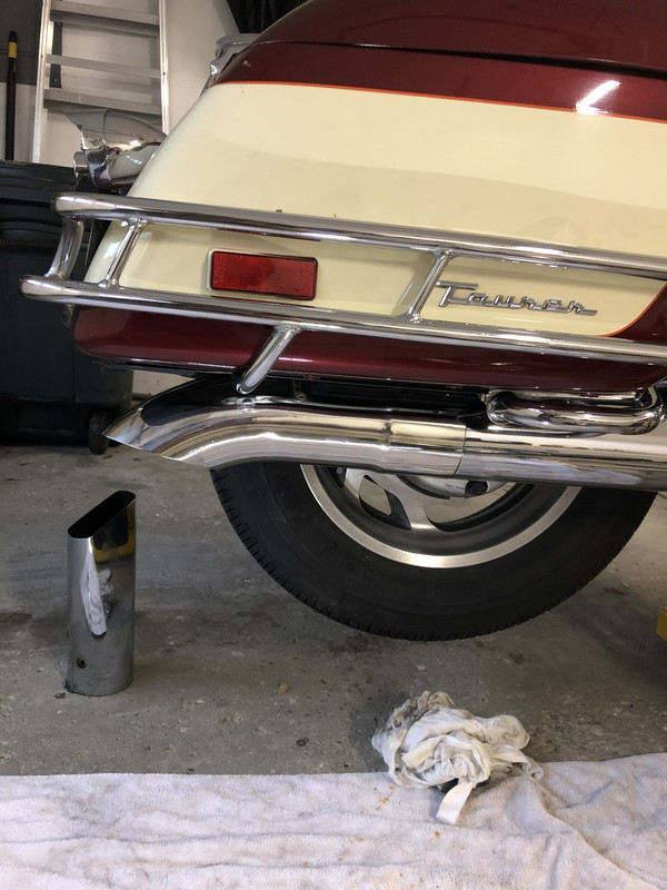

Got my new turn down tips installed.  Getting the stock tips off was a piece of cake.  Slipped off easily once the three bolts were removed.  I would like to post a photo, but can't get photostash to cooperate.  Maybe I can do on the facebook page.

Photos came out larger than expected but look good.  I was trying to decide if I should mount them to exit out the side or down, and ultimately decided on down.  I bought the tips on Amazon for $30 each.  They have an allen bolt on top to squeeze the end together around the stock exhaust.  I used just one of the bolts from the stock exhaust to make sure they don't fall off, but they seem pretty snug after wrenching down the allen bolt.  I did not alter the piggies and there seems to be plenty of room.  Stock is 12", these are 15".
