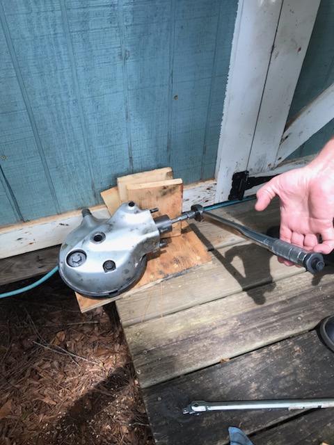

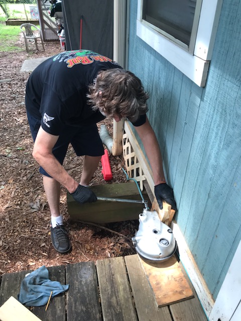

When we did it recently at Stanley Steamer's house, I brought over an old
flange, and we drilled holes that matched the fingers on the flange in a
stout piece of plywood. Then we screwed the piece of plywood to Stanley's
deck next to the building.  That defeated two degrees of freedom, and we
could both loosen the cup nut and torque it back at the end...

Using the wheel to hold the pumpkin and some wooden boards in the slots of the wheel to lock the pumpkin, the nut came off with an air wrench.
Thanks to all for the help

I just put the flange in the pumpkin flange facing up. Then put a piece of wood across holding against two opposing pins stabilized with my foot and let the impact driver rip
