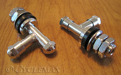

Sorry if this is common knowledge but, while going through the list of things I need to add/remove/change to my new-to-me Goldwing I stumbled upon these guys. Look very promising for those of us who run external TPMS systems on our bikes: (And if you don't have a TPMS setup on your bike, you really REALLY should)
I've ordered a pair to put on the 'wing (Rear already has a metal stem, but the front is icky OEM still) and will report back how it goes. Might need to get a set for my Valk I'm Gonna Keep too if this goes well:
https://cyclemax.com/inc/sdetail/nickel_plated_t_valve_stems/158741/261164

Just makes adding air easier if there is an alarm from your TPMS sensors. The sensors usually have a locking nut, so the T-valve means you have don’t have to get that tool out of wherever it is to add air.
Just have to be careful how it’s oriented so your sensors don’t contact your rotors.

Let us know how you like it, you might change my mind.
As far as the TPMS system, been running 'em on all my bikes for the last few years, is one of the very first things I add to a bike that comes into my possession now (As in the GoldWing already has one installed, yesterday.)
So far hasn't saved me a catastrophe, but did let me know on one of my Inzane trips that my tire had become dangerously under inflated overnight. Never did find a reason, but it lost 20PSI overnight at a hotel on the way to IZ, and let me know about it when we tried to leave in the morning.
Gave me the heads up and time to go put some more air in that tire and be on our way.
Only maint I've had to do to the systems is annually I change the battery in the sender units on each tire and every few months I recharge the head unit via USB. Other than that it's just there keeping a watch on things for me...

I been running TPMS on my Standard for a long time now,, just replace the caps on my metal 90 deg stems. Why do you need a T valve?
That way the sender unit can go on the vertical part and never be removed other than to change batteries, you can add or remove air from the horizontal part of the stem without touching the sender unit.

I’m curious why they only have one rubber seal vs. the two my normal metal valve stems have ?
Also, they look like they don’t have near as much rise. Do you need to cut off the OEM keeper ?
That got me looking, found another type, little cheaper, and appears to have two rubber seals. Think I'll cancel that first order and go with these instead:
https://wingstuff.com/products/37222-t-valve-optional-accessory-for-fobo-2-tpms
That is what I guess I am missing,, my sender unit is my cap and it screws on just like a cap so why is that a problem? Or is it?
Couple things:
-Most of the caps have a security option, if you chose to use that you have a lot more hassle removing and replacing the sender unit.
-Wear and tear on the seal of the sender unit.
-Small bit of air that escapes when removing/replacing the sender unit.
-Adding air in less than ideal conditions, having one less thing to deal with is always a plus.

So my valve stem was just delivered from the above link. Just a heads up, luckily I only really needed one (The rear already has a nice metal valve stem on it, 'cause friends don't let friends drive with OEM valve stems!) but the above link each order is for ONE stem, not a pair...
Just noticed at the bottom of the description "Sold individually."
Oh well, just a heads up...

Make sure that you install them so they are securely attached, as to not come loose. I have fix several metal valve stems that have come apart due to vibration, both inside and outside nut type. These are on the only two wheels you have. Nothing on a motorcycle should be, “do it and forget it.”
Posts: 21967
« Reply #21 on: February 19, 2022, 11:16:43 AM »
...and installed... Had to take it to a shop, my attempts at using C-Clamps, wood working clamps, etc failed miserably once more.... But it's done...
