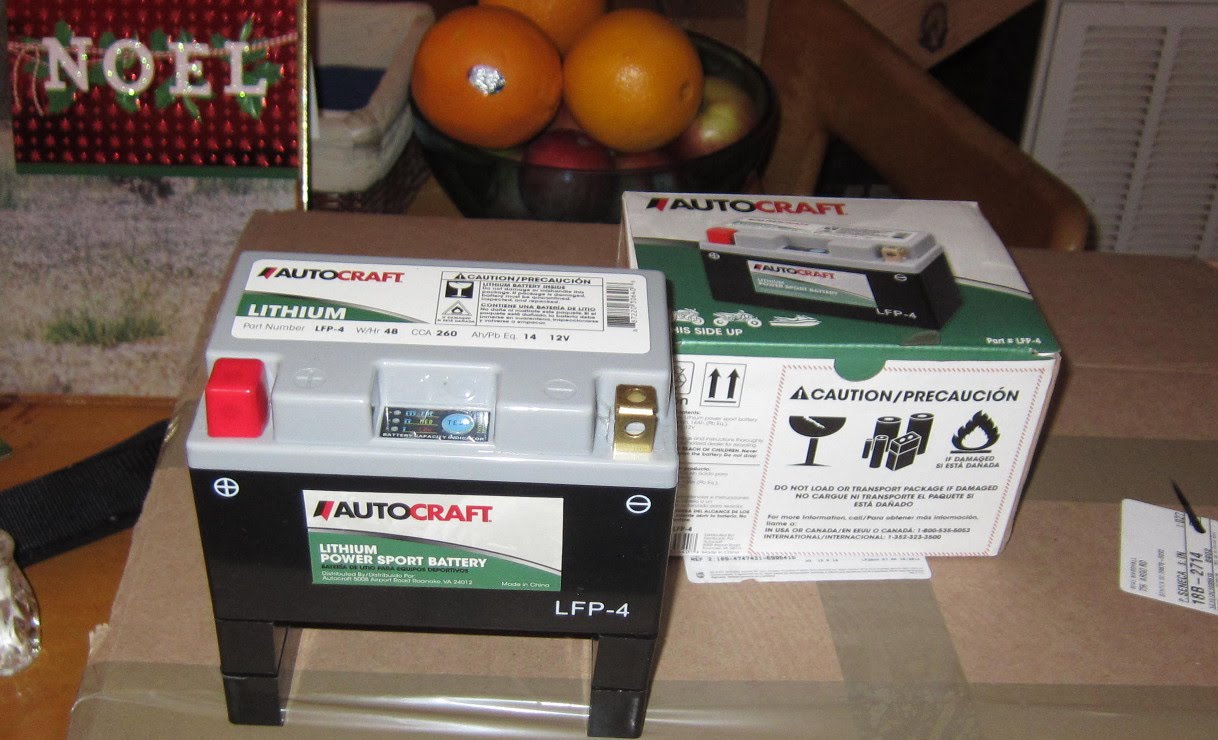

I've never had any trouble out of the battery in my (2014) black bike,
never had to charge it, it always starts up right away. But it is
kind of old, and I'll probably go to InZane this summer. So I put this
battery in the black bike yesterday...
The old battery sure was heavy, it was like there was lead in it or something!
I put a few little stacker frobs they included to make the new battery as
tall as the old one.
Those gold looking connectors are removable and they have multiple
places to make connections. I have one non-oem accessory added
for my heated gear, so now it has its own connection to the battery
instead of being stacked on.
I removed the ground connector from the battery and cut a slit in it so that
the bike's ground connector would fit well. I read some reviews and saw some
people saying stuff like "I had to cut a little tab off my battery wire to fit,
no prob"... bleghhh... I liked being able to modify the battery  cooldude ...
I had to go for a test ride, naturally.

Almost... this is the one they said would fit my bike...
https://www.amazon.com/s?k=noco+nlp20

Glad you found a lighter replacement.  I have Lithium Iron Phosphate batteries in the RV now. They are like a group 27 battery which was very heavy, originally had 2 of those in the 5th wheel.  The Battle Born brand batteries that I replaced them with are much lighter and they are warrantied for 10 years.  Charge voltage/profile are a little different so the converter/charger had to be changed but I put on solar panels and inverter etc. at the same time so we can now "boondock" or dry camp as long as we have some water on board.
I questioned their build quality when they first came out but they have proven to be a good upgrade.  Another big selling point on the ones I have I don't know about yours is that they can be discharged all they way to zero with no harm.  Conventional lead acid once you have done that to them are damaged forever.

This one seems to have a brain that keeps it from over charging or discharging "too much", whatever
that means... here's the porn page from the manufacturer...
https://no.co/products/lithium/powersport
It says "lithium ion"... I think the one I got in December 2014 for The Logtruck
is "lithium iron phosphate", that's what Tesla uses now in their standard-range
cars.
I don't think they make the autocraft one anymore, but I sure do like it.
I particularly like the tester button on it, I wish the Noco battery had one.
Anywho... they're supposed to last a long time. My original regular battery from the
black bike is from 2014 too, and it still works great, so ida know... I'm glad
to have a fresh battery for this summer's long rides though...

Yep BMS Battery Management System is the brains of the little box.  Another plus is that as stated in the link you don't need to worry about boiling out the water as there is none inside.  You can mount it sideways or upside down if you want.  The RV applications allow you to put them underneath your bed if you want with no worry about charging gases or leakage.  The type I have are actually made of lots of small cells in series inside the box with the BMS.  The charge controller for the solar stuff and the inverter are all made by Victron and I have an app on the phone that allows me to see and modify parameters and state of charge etc.  Cool stuff.
