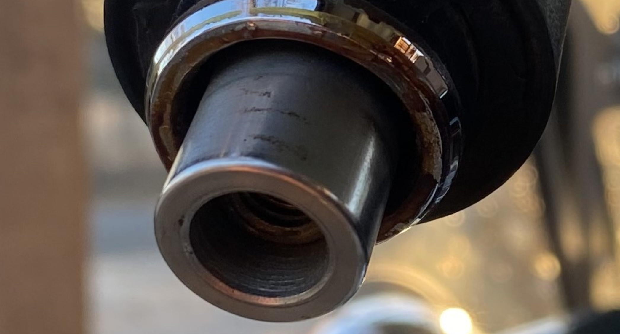

I am sort of new to the board and love the info you guys put out.  I just got a 1998 Tourer up and running.  Long story short I bought the bike from an old friend.  He was not able to ride anymore, and the bike has been sitting since 2012.  I went through the carbs and flushed all the fluids and coolant.  Oil change, filter and new plugs.  Man this bike runs great.  Been enjoying every minute of my rides.  Little by little I'm working out a few kinks.  The tach is still not working so that is a upcoming project.  My question here is the clutch side grip is missing the end piece.  The right side is great with the throttle lock intact.  I was hoping to find this piece and replace it.  All the parts drawings I come across only have the part number for the brake side grip.  The left side (clutch) has a small tube sticking out with internal threads.  Anyone know where I can get this end cap ? Looks like it uses a bolt with an allen head like the throttle lock cap.  Any suggestions would greatly be appreciated.

Even if you had a new plastic cap, it’s not going to fit the way that is situated. Verify the switch housing is correctly positioned with the locator pin in its little hole. If it is then I think the wrong grip is installed or someone shortened it for some reason. New grips seem the best answer.

Agreed, the grip is inset too far in, for whatever reasons. There is a handlebar grips on ebay for $8 ($9 shipping) here. However, it's unclear from the photos which grip end is damaged. Email the seller, etc. The item has a *make offer* option that you might opt for due to the relatively high economy shipping price, imho. The seller doesn't need to ship both grips, also.

The other guys must not have zoomed in on your weird tube...
It reminds me of the place to screw in the weight for the weighted
bars that came on my 2014 Valkyrie.
There's some weird stuff going on with your bars  cooldude ...
Do your bars look anything like this?
I don't remember that the end cap comes off on the clutch side. I
wonder if your bike was changed around to use bar-end mirrors or
something?

if your bars look like hubcapsc's ..... the Left handlebar grip's p/n is 53166-KCR-000. If the oem website is correct, a ton of honda bikes use the same grip. Click here and hit the "where used" button.
That's just in case you rather buy a cheaper used grip. The chrome end cap is not sold separately. The Right end cap is sold separately but I doubt if they're interchangeable.

« Reply #5 on: February 23, 2022, 06:26:39 AM »
Definitely not stock. I've been using the same Kuryakyn ISO grips 2 bikes/65,000 mi. I had cramping issues with stock grips being smaller in dia. Kury's are larger dia. and they have a feature to add a palm assist Throttle Boss.

Thanks for the input.  I guess I wasn't clear on my original post.  I know the grips are not stock.  I was hoping someone would recognize the modification.  The PO told me he added the grips back around 2000.  Lost the clutch side after he laid the bike over once.  I believe the set was a mechanical assist throttle lock and weighted clutch side.  I'll post a pic on the throttle side.  It is still intact and works great.   I have searched all the parts diagrams and sure that is not helpful.  My background is aircraft mechanic and pilot so pretty use to parts diagrams.  I was just looking to see if anyone recognized the brand maybe.

« Reply #14 on: February 25, 2022, 05:22:54 AM »
Looks like a Throttlemeister set up.

« Reply #15 on: February 25, 2022, 10:07:22 AM »
Possible "direction".....
https://www.amazon.com/Throttlemeister-Control-Motorcycles-FH-AB9/dp/B01CKLH4DM

« Reply #16 on: February 26, 2022, 02:29:19 PM »
Thanks Bassman and Speedy Coop.  Thats exactly the info I was looking for. Already found one on Ebay.
It was a Throttlemeister.  Once I ran that Info across the original owner his 85 year old mind immediately remembered that !!  Thanks.
