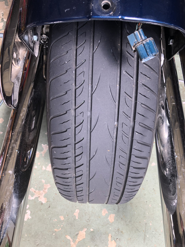

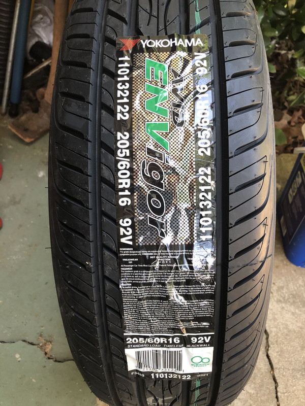

On my second one of these. I like it.
First one after 18,700 miles.

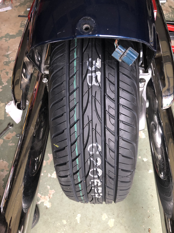

Ready to go... Also has rounded shoulders.
