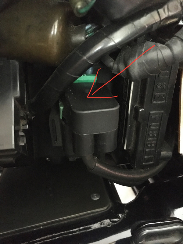

I almost guarantee it’s the wires connected to the starting solenoid behind the right side cover. The next time it could blow apart and not start

Posts: 14897
« Reply #6 on: March 03, 2022, 06:45:34 AM »
Look into the electrical under the right side, cleaned and coated all connections with dialectic grease. Check all wires and cables for damage and everything looks fine. Some of the connections were dirty and some had a small amount of corrosion.
Still debating on taking it or the B to bike week.
Specifically I’m talking about the red connector on the back of this guy.
Mine exploded so I direct wired it. It’s a common problem

I looked at those connections, they looked new.  I cleaned the whole area around it. So when you direct wired you just eliminated the connectors?  I will keep an eye on it but I assume when it goes there isn't much of a warning.
