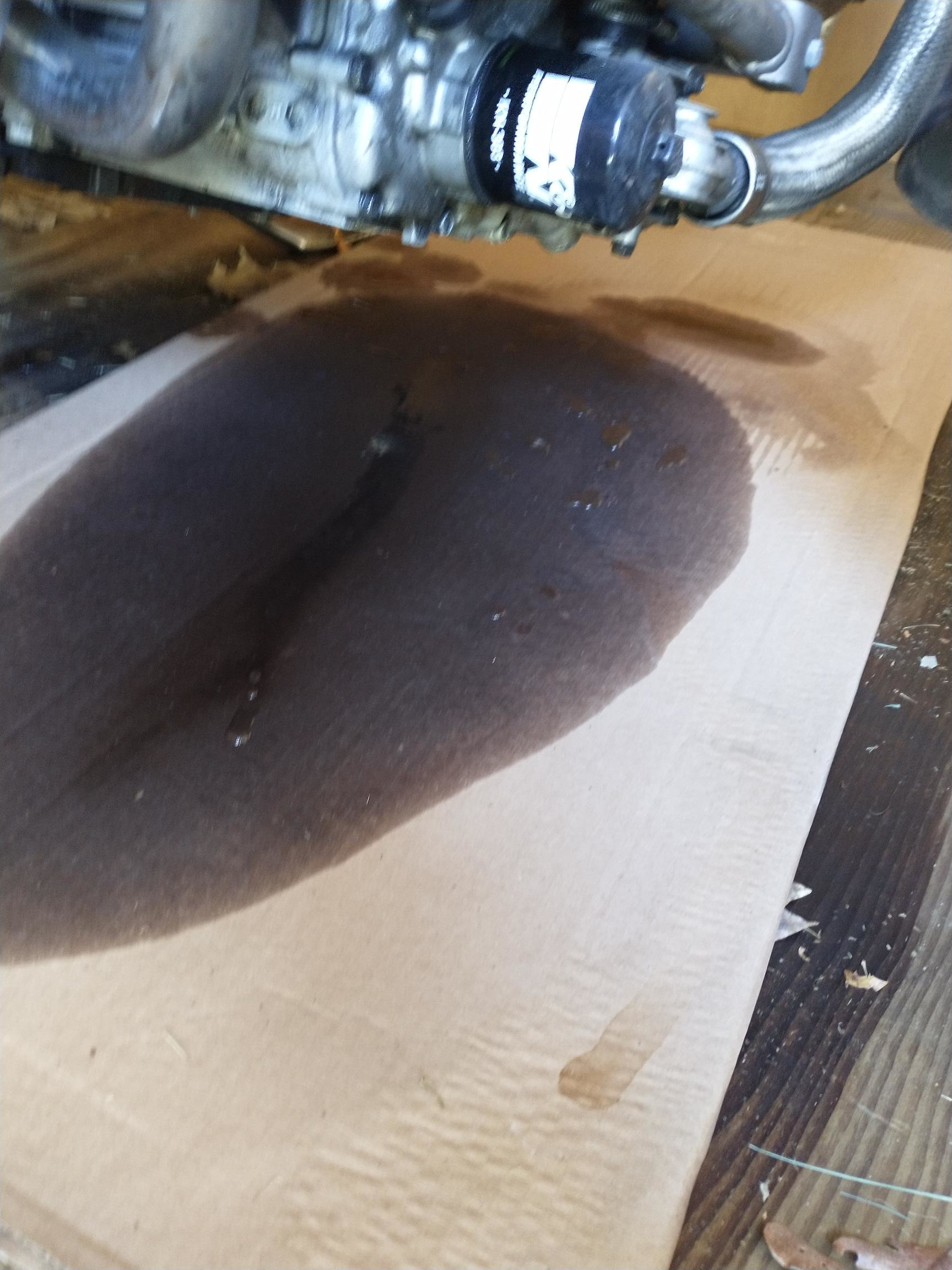

I'm contemplating the coming spring.  Thinking I'll put the Valk on the jack and do some of the things that I didn't get to when I resurrected it in Daytona Beach.  I can't put it off any more because of the two pictures below.  It now marks it's territory more than both my 40+ year old Harleys put together.  I'm thinking it's the rocker cover gasket though I haven't even leaned the bike up since I dropped it on it's stand last December for the winter so can't tell exactly where it's getting out.  Any suggestions would be appreciated.
I have a couple pictures of the pond of oil under it but I wasn't able to get them to load.  I'll add them when I remember how to do it.

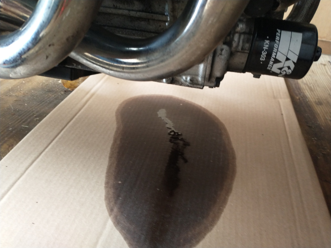

Well, trying again with the pictures.  I added pictures with smaller file sizes but didn't put any text in and it didn't like that -- SO PICKY!!!
AH, THERE THEY ARE.  One upside down and one sideways, ever inventive software.
The top one was taken in mid December, the second in mid February.  I think I'll name the resulting body of oil, Lake Oleo.  Oh well, I won't have to change oil this spring, just add.

With such degraded pictures it’s hard to tell because zooming in is so blurry. Could it be just the oil filter not tight?

It's not coming from the oil filter, it's somewhere on the left side of the bike.  The bike is so close to the side of the trailer that I'll have to crawl in somehow to see what's right above the patch and I'm going to wait for warm weather to do that.  Hadn't thought of the shifter shaft, thanks.

The shifter shaft would not make an oil slick that large

How about the O-ring on the back of the water pump where it goes into the engine block? I had one that was bad and made a mess on the bottom of the engine.

Do not clean the bike at all.
Then, in the dark, use a flashlight to carefully follow the shiny stuff upward.

Check and make sure your gas didn’t fill the engine and overflow the oil. I would definitely pull the plugs before trying to turn it over after sitting that long.

Here are the pics again.

Yesterday I squzzed (that's a technical term and the past, future participle of 'got myself into a space I almost couldn't get out of without a hoist) myself in beside the Valk and was able to get one eye to focus on the left underside of the engine.
From this different perspective it became apparent that there were 2 fluids that had accumulated on the cardboard.  One was water, the other oil.  The water was the majority of the wet spot on the cardboard and it is condensation dripping down the side of the engine, it's not a concern from the perspective of leak detection.
The oil constituted a small stain in the center of the large water stain and I think (not positive) that it's coming from the shifter shaft.  Once it's actually spring, I'm going to get the Valk on my jack and I'll be able to get a better look at it.
I took pictures but they're so dark as to useless.
« Reply #14 on: March 16, 2022, 08:22:47 AM »

The way the oil is dripping out in that particular line of drips makes it look like the source of that drip could be under the timing cover...  You think?
    Like maybe that seal around the water pump, as mentioned above, or any  seal up u
nder that cover.
