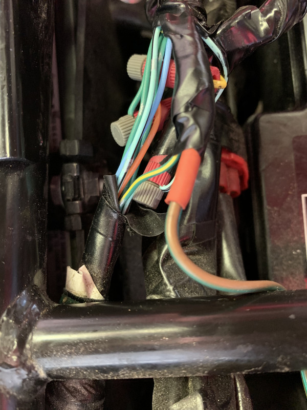

No green with yellow stripe on my bike in the 2 bundles under the seat.
I don't have a green wire with the yellow stripe .
I did find another post stating on their bike the brake wire was black/yellow.
I have one of those and wired everything up before final fixing.
Bike on, brake lever pulled and NUTTIN! NUTTIN I TELL YOU.
All my wire joins and twisted and soldered. I don't know if the brake wire splice is good and I didn't ry a volt meter to see it the wire at the LED strips was live.
I did connect the ground to the negative terminal. Wrong or right???
The thin bundle.

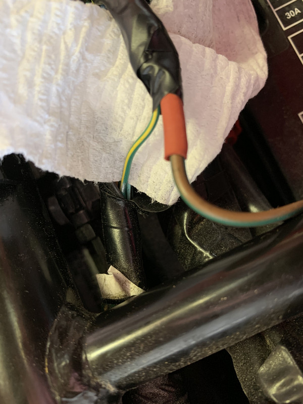

« Reply #4 on: March 19, 2022, 05:12:45 PM »
I found a pic from when I did mine. The yellow is hard to spot, it was on the bottom side of the wire, not visible from the top and of course that wire was on the bottom of the bundle so harder to locate. You can barely see the yellow in my pic. This is the smaller of the bundles and mine had the white label on it. Hope this can help. Test it before you solder this time. It's there, just tough to locate.
« Reply #5 on: March 20, 2022, 06:19:08 AM »
That's on top/next to the battery?

« Reply #6 on: March 20, 2022, 11:46:39 AM »
yes
« Reply #7 on: March 20, 2022, 12:30:40 PM »
yes
Thank you, thank you. I was rooting through the wrong bundles.
I found IT!

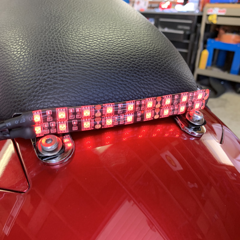

« Reply #8 on: March 24, 2022, 08:43:38 AM »
Ta Da! I have extra brake lights.
Putting the bike back together a thought flashed across my brain.
Can I simply splice into the positive for the LED strips and add more LED strips to the uprights of the saddlebag mounts? And of course splice into the ground.
