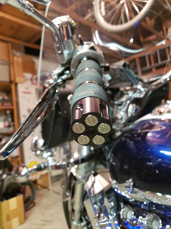

« on: May 05, 2022, 07:47:18 PM »
 Cheesy

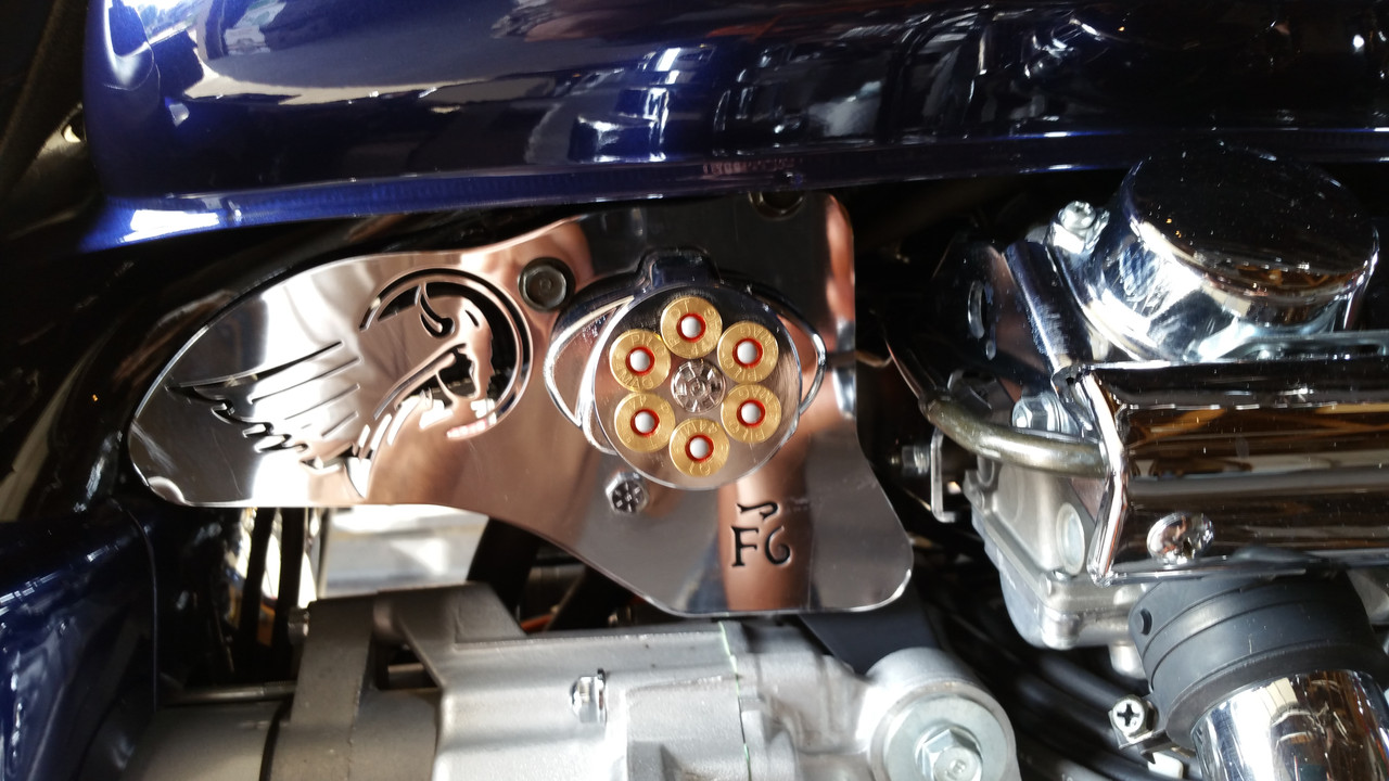

To match my key  Cool

The primers on the grips have been hit by a firing pin, but the ones on the key haven't (though I've never seen white primers).

nice looking grips.  How hard to install those Avon grips and where get at, etc?
My 98 Valk has the chrome/rubber cushioned grips and pretty tacky feeling when HOT out, getting pretty worn out, but still look nice from a distance.
DarkSideR
Posts: 1795
Pueblo, Colorado
« Reply #9 on: May 07, 2022, 04:47:44 AM »
I purchased them directly from Avon. I suggest looking up the number calling them and ordering from them.
The install was maybe a 4 out of 10 for difficulty. And the only reason it's a four is because you have to take apart the throttle assembly on the right handle and reconnect the cables. And you have to lift the front of the gas tank up to adjust the cables.

« Reply #10 on: May 07, 2022, 08:23:15 AM »
They look good!  cooldude
I had considered Avon grips, but the fitment chart only shows the 14-15 Valkyrie, not our fist gens.
http://avongrips-com.3dcartstores.com/Metric-Touring-Fitment-Chart-_c_209.html
According to their website, the throttle tube has multiple throttle cams that interchange so the same grip can work for multiple applications. So, does one of the supplied cams work A-OK with the Valkyrie cables/adjustments? Or did you need to customize anything to get them to work?
I'd appreciate any comments and/or part numbers used. Thanks.
I have 97-03  Valkyrie bars on my 2014 Valkyrie. The 2014 controls fit
the 97-03 Valkyrie bars.

Understood, but wasn't sure. If I am not talking out of my rear section, didn't Kuryakyn have a special Iso-grip for the Valkyrie because of bar length or something of the sort? I was never 100% clear on what the difference between my 1" bars and the 1" bars on every other metric bike out there, but never looked deep into what Kuryakyn decided we needed vs. the others.
Posts: 30819
« Reply #18 on: May 10, 2022, 01:28:49 PM »
Yes, on the Kury ISO grips, the regualar/universals were 5 3/4" long, and the specials for Valk were 6 1/4".
(now this is from memory, so I might be off a bit, but I don't think so)
The thing was, with the Valk specials (longer) you had to drop a spacer in the grips before mounting, for stiffness, since they were longer than the bar ends; with the tops touching the controls.  Even though the Valk bars are long, the regular 5 3/4 grips were all that were necessary, up to the controls.  So it wasn't a bar length thing, it was a looks thing.
I did not need that long of grips, but what I liked was the throttle boss at the end on the right did not interfere with my hand on normal riding (which it will on std length grips).  When I wanted to use the boss, I slid my hand down to it.

Tell me more about the grip ends please
I don't think they are an add on. The entire grip must be purchased.
