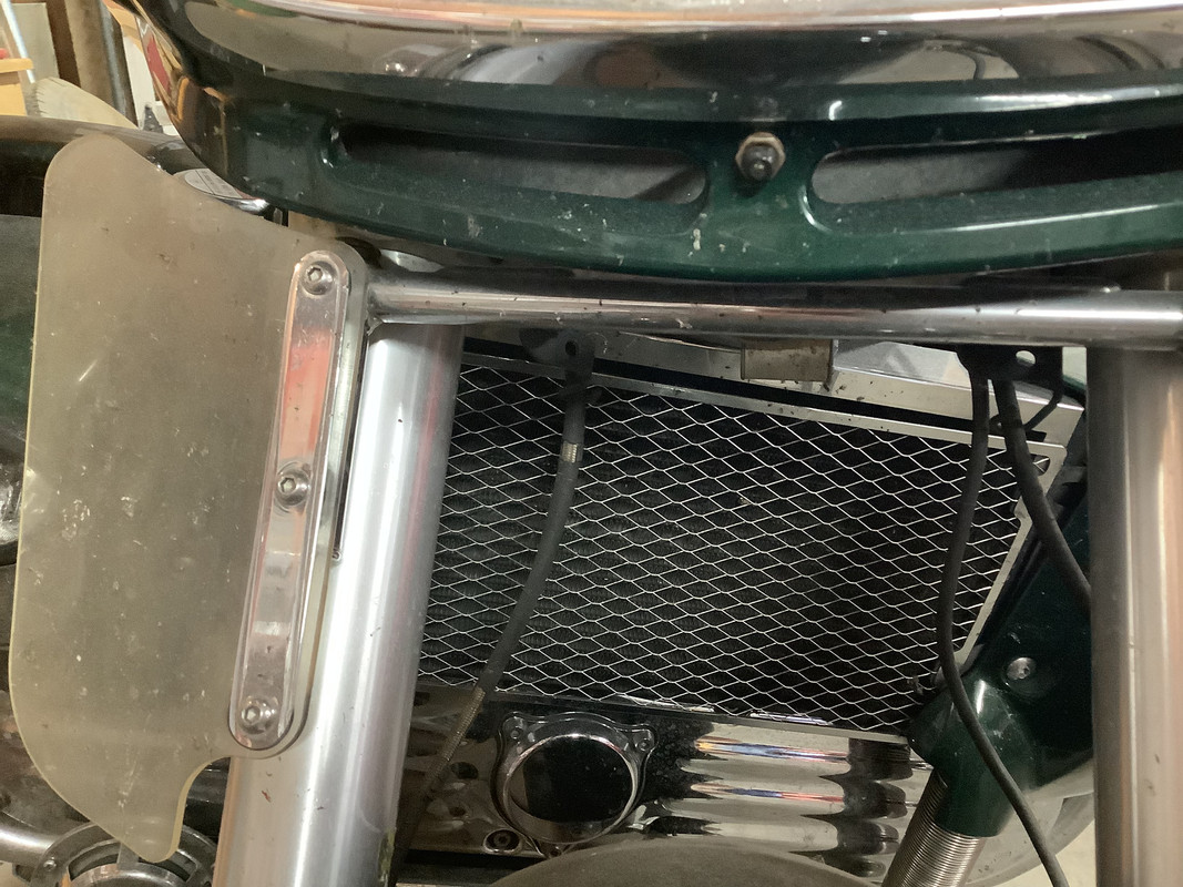

« Reply #3 on: May 10, 2022, 05:47:53 PM »
These kind ?
If so, the bar is 10.5 inches wide and the two side bars are 4” long. It’s almost impossible to get an accurate measurement on the stepped mounting bars without removal though.

« Reply #7 on: May 11, 2022, 08:07:25 AM »
@emperor:
Yes, that's exactly what I'm looking for.  I'm guessing that the only real mounting point here is the bolts that hold on the brake line brackets?  The jog should be easy enough to figure out, I think.  Do you find that this design of acrylic does a decent job of blocking the air flow from either side of the front of the tank?
No, the mount points are not the brake line brackets but two threaded holes up under the lower triple tree. Thus why they have a couple doglegs in the brackets. As to their effectiveness, they block the under tank wind well. But to be honest I’ve never removed these to compare without. On my Standard I have a set of Memphis Lowers which work much the same. And I can attest to the difference without them.
