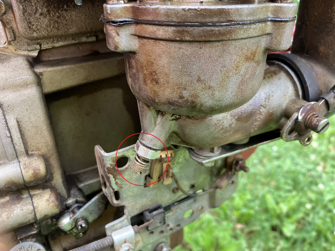

It's an 8 HP Briggs & Stratton on a Troy Bilt tiller. It ran like a top until this morning. To me, it acts like it is starved for fuel. Fuel flow to the carb is fine. Spark plug looks good. This is not my area of expertise. First video starts at idle and then wide open throttle. Second video is all wide open throttle.
This morning, it was running great for twenty foot through the garden and then bogged down like it was out of gas. Restarted and made it only another foot.
EDIT: Forgot to add that air filter looks fine.
Any ideas?
https://youtube.com/shorts/iTdp3uvjf4M
https://youtube.com/shorts/MkQsi2S0iIc
UPDATE: Cleaned the small holes on the carburetor nozzle and adjusted the high speed valve. Problem solved and runs great. See details Here

Have you tried adjusting the carburetor ? There may be both low/idle and high speed adjustments. The high speed is in both video's near the bottom of the carb. in is lean, out is rich. Try turning the screw out about 1/8 turn. Try it see what happens. Try another 1/8 turn out see what happens. Thats a float carburetor and it seems like there may be some junk [ technical term] in the float needle valve which is kinda common. Access to the float is by removing the float chamber [ the thingy that the needle valve is mounted to. Generally that can be removed and looked without removing the carburetor. Try to be careful not to ruin the gasket.

No diaphram  on that carb.  I would take the high speed jet (coming at an angle from the bottom of carb ) out and let it drain to see if any trash is there. Also note if the flow is steady(perhaps the supply line has an issue). Install the jet back in place start engine and make high speed jet adjustments. From the sound and lack of black smoke I would turn CCW and see if that helps . It does seem to be starving.

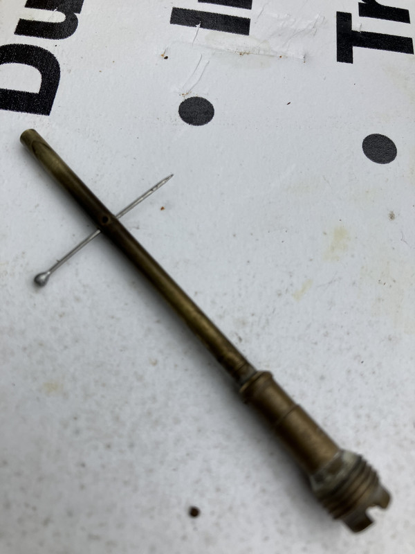

If you remove the high speed needle and seat there will be a long brass main nozzle inside that.  It is threaded through the two halves of carb. A good hollow ground srew driver will remove it. ( note, must be removed before any attempt to separate halves)
You may find some debris there if it is a fuel issue

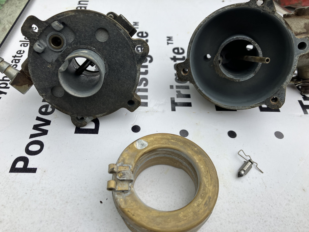

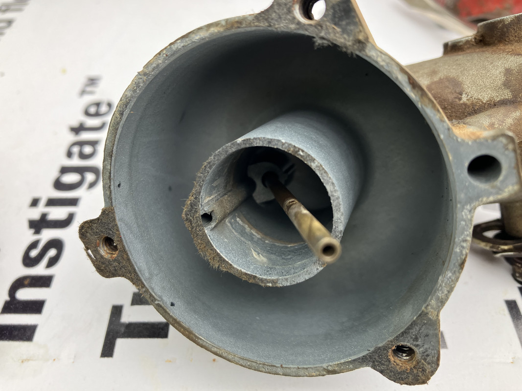

« Reply #18 on: June 19, 2022, 11:20:20 AM »
Finally made time work on the tiller (my wife wanted the garden tilled).
I replaced the spark plug and there was no change.
I removed and disassembled the carburetor. I was amazed at how clean it was inside.
The only problem I could find was one or two of the pin holes on the carburetor nozzle were plugged.
Cleared that and reassembled the carburetor. There was improvement in wide open throttle, but still stalled out under load. A slight adjustment of the high speed valve cured the problem.
I am good to go. Thanks for all the suggestions and advice.
