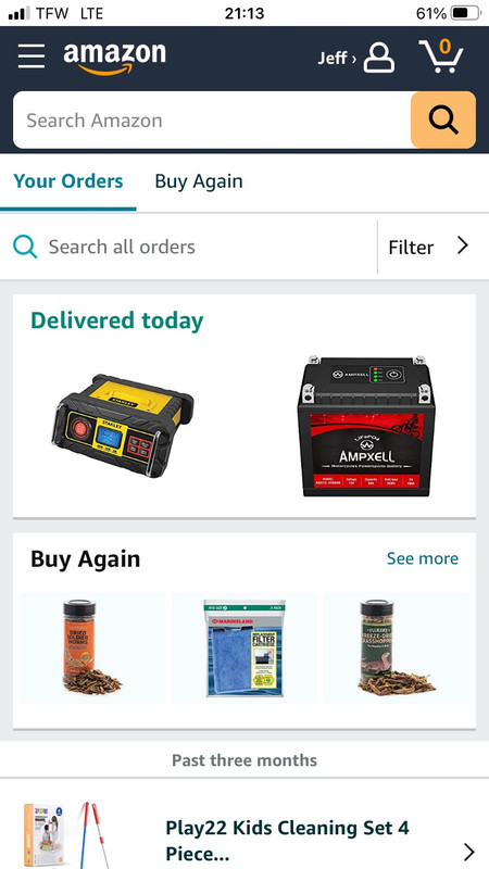

Did an experiment. My battery is only two old at most and still strong. But after a small bit of research and with the help of my SIL who knows batteries better than I do we picked out a lithium battery for the bike. The thing came last night with s new charger. Only took a minute to get the orange light (full charge) on the battery. Yes it’s a “smart” battery. It also disconnects itself from the input from the alternator when it doesn’t need more juice. This has to be good for the alternator. Hold 14V without the engine running and has 480 CCA. Lights are brighter and starts quickly.
The new charger even reconditioned my bad old old battery so now it’s holding a full charge.
So far so good.
