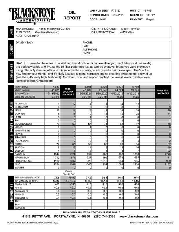

« Reply #14 on: August 01, 2022, 07:08:13 AM »
speaking of oil and brought up SUPERTECH oil at Walmart,  has anyone been using for their autos the Supertech OIL FILTERS?   I am having a harder time finding AC delco oil filters at my local store and the price has gone up as well on them.   I read reviews on youtube and I went into Walmart and compared to the K&N and Mobil 1 oil filters looking inside and look identical to me.  At 2.90 for 10K mile white one and 20K mile one in blue for 5.90 is hard to beat the price for sure.    Only difference, according to utube video between the 2 is a silicone vs. rubber seal in them and figure if changing oil every 5K miles at 2.90 the rubber seal is good enough for a general oil change on vehicles.
Might have to be making trips to Walmart more so to get oil as well my local Farm and Fleet has not been having my cheaper Citgo Supergard semi-synthetic oil on sale past 1 year or more.  All sales are now on FULL synthetic oil and the price difference is only like 1 to 1.50 per quart is all nowadays.   I guess more and more NEW cars are requiring FULL synthetic oils but what about older cars just running and needing regular conventional oil?
Thank you for posting the UOA, Britman. I've been running these on all of my vehicles for many years, and this particular one will come in handy for comparison on my still new-to-me Valkyrie.
I'm a bit surprised at the shearing in this particular engine. The FC6 configuration seems less likely to shear the oil in such a relatively short OCI. I've seen Mobil 1 perform quite well in many of my own UOAs (in a variety of motorcycle, car and truck engines), but I would be curious to see how a more shear-resistant oil would hold up for the same interval length. I've personally had excellent results with Amsoil's fully synthetic signature oil when I have dealt with engines that were prone to shearing down oil. That said, since the viscosity in most of your listed UOAs seems either borderline or just below the expected values, it might be cheaper to simply stick with shorter intervals.

« Reply #16 on: August 01, 2022, 09:23:01 AM »
that's a 10k mile oil change oil. change filter at 5k miles top off he oil level and go another 5k miles. UOA would most likely shown good for 15k miles.
honda states 8k mile oil change with their dino oil. boxer style engines have very little wear.
The borderline viscosity values of both the current and previous UOAs suggest that going significantly longer would further shear the oil down to lower weights, which would in turn likely increase wear.
David -- out of curiosity, did you clean/replace the airfilter recently? Or just use a different oil filter? The drop in both aluminum and silicon in this UOA is significant (even with the slightly shorter OCI) compared to the previous ones.

« Reply #17 on: August 01, 2022, 10:17:25 AM »
Not my chart. Just something I saw posted re SuperTech filters

« Reply #19 on: August 01, 2022, 01:06:53 PM »
Actually that's the latest UOA for my F6B. I ran it because it was the first oil change since switching to a Super Tech oil filter, and I wanted to see if anything changed. I had been using Bosch but the local stores quit carrying them so I went with the Super Tech. BTW this is the cheaper ST version, rated at 10,000 miles as I remember.
As you can see the results were great, actually better than before. So I'll stay with these inexpensive filters.
You'll notice that the results improved at every oil change. When the F6B was new I was a little concerned that wear metals were higher than the GL1800 averages, but the numbers have been improving at every change and now they're better than average. These bikes must have a LONG break in! As for the question about the air filter, the bike still had the original filter when I ran this test. I recently changed that filter (a gruesome 3 hour job on a GL1800) at 47,040 miles.
FYI I recently tested my 1998 Tourer with over 176,000 miles, and the results were very similar to the GL1800. I've posted both results below.

« Reply #21 on: August 01, 2022, 01:27:50 PM »
Keep in mind that these viscosity numbers are for a 15W-50 oil. The 'should be' numbers for the 5W-30 I run in my car and truck are considerably lower:
SUS Viscosity @ 210°F should be: 55-63
cSt Viscosity @ 100°C should be: 8.8-11.3

« Reply #22 on: August 01, 2022, 02:55:19 PM »
Good point! The higher initial viscosity certainly mitigates some of the issue of the oil shearing down. I'd love to see a comparison with a more shear-resistant oil.

« Reply #23 on: August 01, 2022, 03:03:56 PM »
I suspect they all shear down near the bottom of the 'should be' range after several thousand miles. I tested my car last December with 7900 miles. It was 56.7 and 9.26, which are near the bottom of the 5W-30 ranges stated above.

« Reply #24 on: August 01, 2022, 05:44:23 PM »
I found this conversion chart on BobIsTheOilGuy.com It tells me that after only 2388 miles, the 15W-50 oil in my Valkyrie sheared down to a (Something)W-40. Undoubtedly other grades will shear at a similar rate. It makes me wonder about the 5W-20 oil so many vehicles call for.
