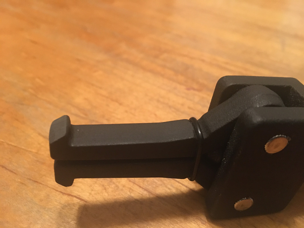

I actually converted a pilot bearing puller to work on our wheel bearings and it works better than any actual wheel puller I have ever used.
