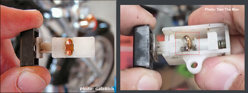

Hi everyone-(1997 Tourer 34k)spent the week at Mid Ohio Vintage days. Put over 800 miles on it last week. I was 35 miles from home, filled it up would not start Dead. Check wiring and fuses
on the right side of the battery and found a loose connector put it back together. Still would not start.(starter dead)The starter is dead hit the start switch nothing. Check other connector and fuses not sure where to start. Not only there is response from the starter but the headlight is not working on dim or brights. Any help is appreciated thanks in advance.

Along with the headlight issue, it really sounds like the starter button needs serviced.

Agreed, the symptoms sounds like the start button. You're looking for a sunken copper bridge as the culprit on the start button's movable contact. It's accessible by taking
off the white box in the bottom pics. You'll have to take the Right-side clamshell on the handlebar apart to begin of course.
4 barbs clip the white box to the stationary contact plate (black lid).

I agree with starter button maintenance IF. The battery cables are checked and tight. Also function the kill switch a thousand times and see if that’s it
« Reply #4 on: July 26, 2022, 05:32:12 AM »
Be very careful with the little spring in the starter switch.
BOING and it's gone for ever.
Still won’t start. I took the starter switch out and cleaned it. The “copper bridge” looked chewed up. I cleaned it the best I could put it back together ands the starter button is dead. However the bike did start when I jumper between the two post so the starter works. Do I just buy a new switch? Or is their something else I can do?

The little brass thingy has to be able to bounce up and down on it’s spring. I usually have to trim a little plastic with an exacto knife. If it’s stuck in there it still won’t work even if it’s clean

If the copper bridge hasn't melted into the nylon substrate like the pic below, it may still be fixable. *Fixable* doesn't equate to being *reliable* though. In order replace the push button you'd have to buy the entire Right side clamshell.

I just order a new unit yesterday. I took in consider reliability issues if I did get it to work. I took a small exacto  knife and move a bunch of plastic and could not get the “copper bridge”
free to float -  decided I would feel better with a new switch on it. Thanks everyone.
