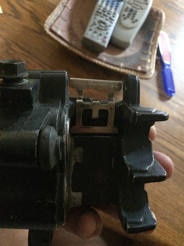

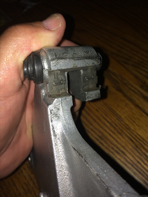

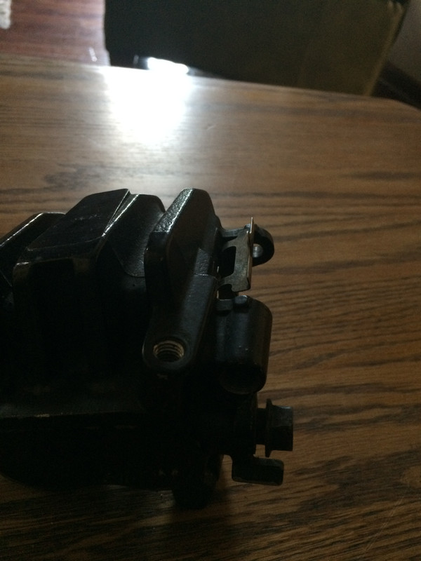

Need some help.  I've browsed here and not found an answer, same on youtube.  SO.....replaced my rear pads and in the process a metal "clip" fell out.  On fiche, it's listed as "spring, pad".  Need to know how/where it fits.
Any help is appreciated.

« Reply #1 on: July 26, 2022, 11:26:12 AM »
Hope that helps

« Reply #2 on: July 26, 2022, 12:26:08 PM »
MANY THANKS!  That's where I installed it, seemed like the only place it would be appropriate.  Nice of you to take the time, verify it for me.  Now I can go for a test ride.  Pedal still not strong tho, maybe with the ride.
