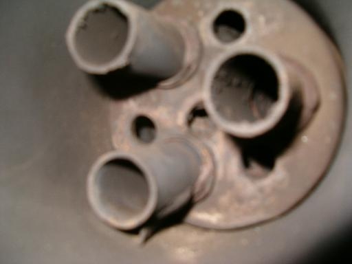

Cut off the piggies.  Have a welder buddy silver braze a 1/2" drill to a length of cold roll the same diameter.  Run that through each hole. Not too loud and sounds nice.  I could send mine.  I've no need for it now.  PM me if you want, crow

I cut my "piggies" and drilled a 1/4 inch hole through the baffles, on stock exhaust.  Sounds just right to me.  Not obnoxiously loud, but has a little more "growl".
I did this right when I bought the bike.....WAY before I knew how "priceless" a virgin stock exhaust system would go for today!!   Lol!!
That was done to my bike before I got it.

Cut piggies alone can be fixed (if you leave something to attach back to).  Drilling and hacking is pretty permanent.

You can size and use a tapered pipe tap those holes to fit a tapered pipe plug to restore them.
NO!!!   I did not drill through the backplate!  But the actual baffle itself!  I bought like a foot long drill bit, to do it.  That would reach way down into the tubes themselves.
I agree, drilling the backplate was a TOTAL HACK JOB!!
